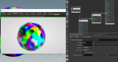

Attached is a simple example HIP. Basically any displacement fed into a material node breaks any point attributes used in the material. Using a procedural texture in the HIP but this happens with loaded textures as well. If you disconnect the displacement, the point attribute will read correctly, with displacement connected, point attributes no longer work.
I'm not sure if this is an existing limitation or a new bug but this kills a lot of my workflow if I cant get displacement alongside point attribs. I've been shifting back to Octane from Redshift because of the improved network rendering but this has been causing a number of blocker issues for me.
Thanks for any assist juanjgon!

The new Vertex Displacement node does not break attributes. Unfortunately for typical float texture displacement, the Vertex Displacement node is about an order of magnitude slower to achieve similar results.

You could use procedural with the new one abnd as far i remenber you can't set up subdiv level at shader level with the older
The vertex displacement works like the conventional tessellation and displacement features found in near all other CPU and GPU renderers, computing a physically subdivided/displaced mesh before rendering the scene. The old Octane displacement node works at render time, without physically subdivide or displace the base mesh.
