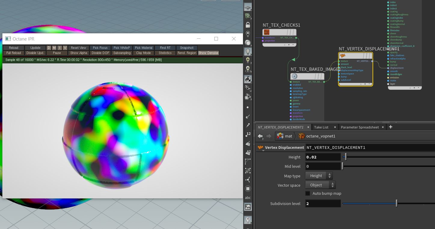

juanjgon
Posts: 8867
Location: Spain
Yes, sorry, this is a known limitation of the conventional old displacement node, although I think that this is a planned feature in the short term.
Meanwhile, the solution is to use the new vertex displacement node, that doesn't have this limitation.
Thanks,
-Juanjo
