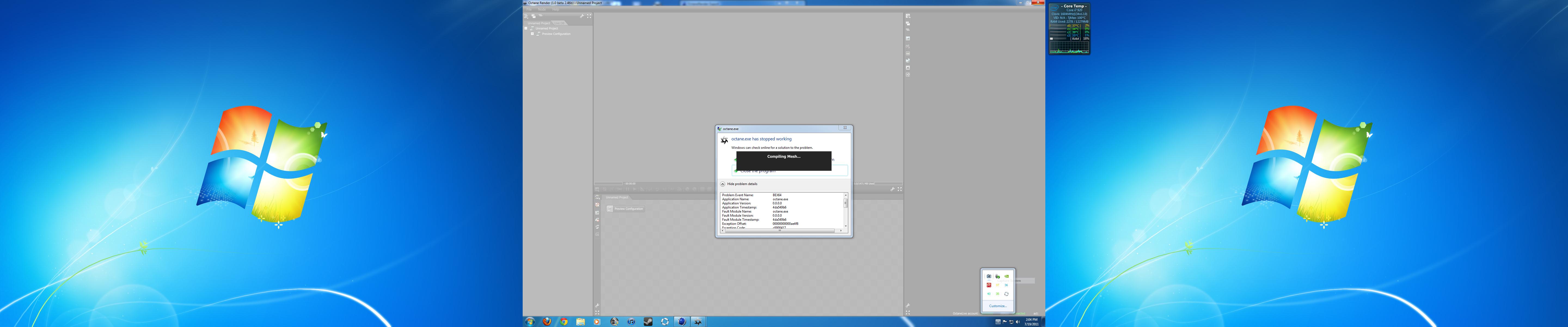

I had everything working great using the Cuda 3.0 with SLI- My boot drive went down, had to start over from scratch. Upon re-installing everything as before, I now get a crash immediately upon hitting "render". (using C4D plugin) Octane DOES launch on it's own, but always crashes out of C4D. I have tried re-installing Octane, the plugin, and tried both versions of Cuda to no avail.
Running i7920, Win64 Ult, 2 x GTX480 , C4D Studio 12.

Have you test to export a simple cube?
Sometimes it can be that a mesh is corrupt, means there are double edges or vertices...

That was it- cube went fine. Must be the model/mesh. Thanks!
