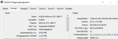

D. What's your driver version? Numbers are not known by me
Also post bugreport.zip, it's required.
moebius
Posts: 95
Joined: Tue Mar 17, 2015 2:18 pm

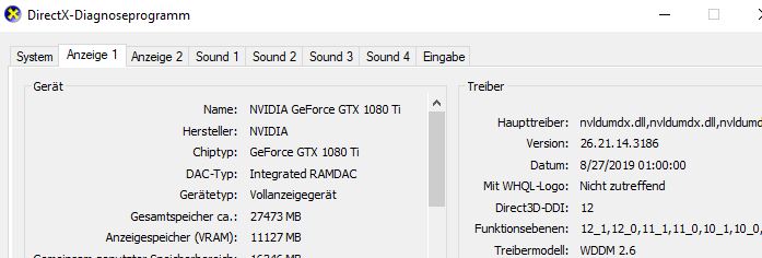

Driver is that what it says, and Windows says I have the best drivers it can find

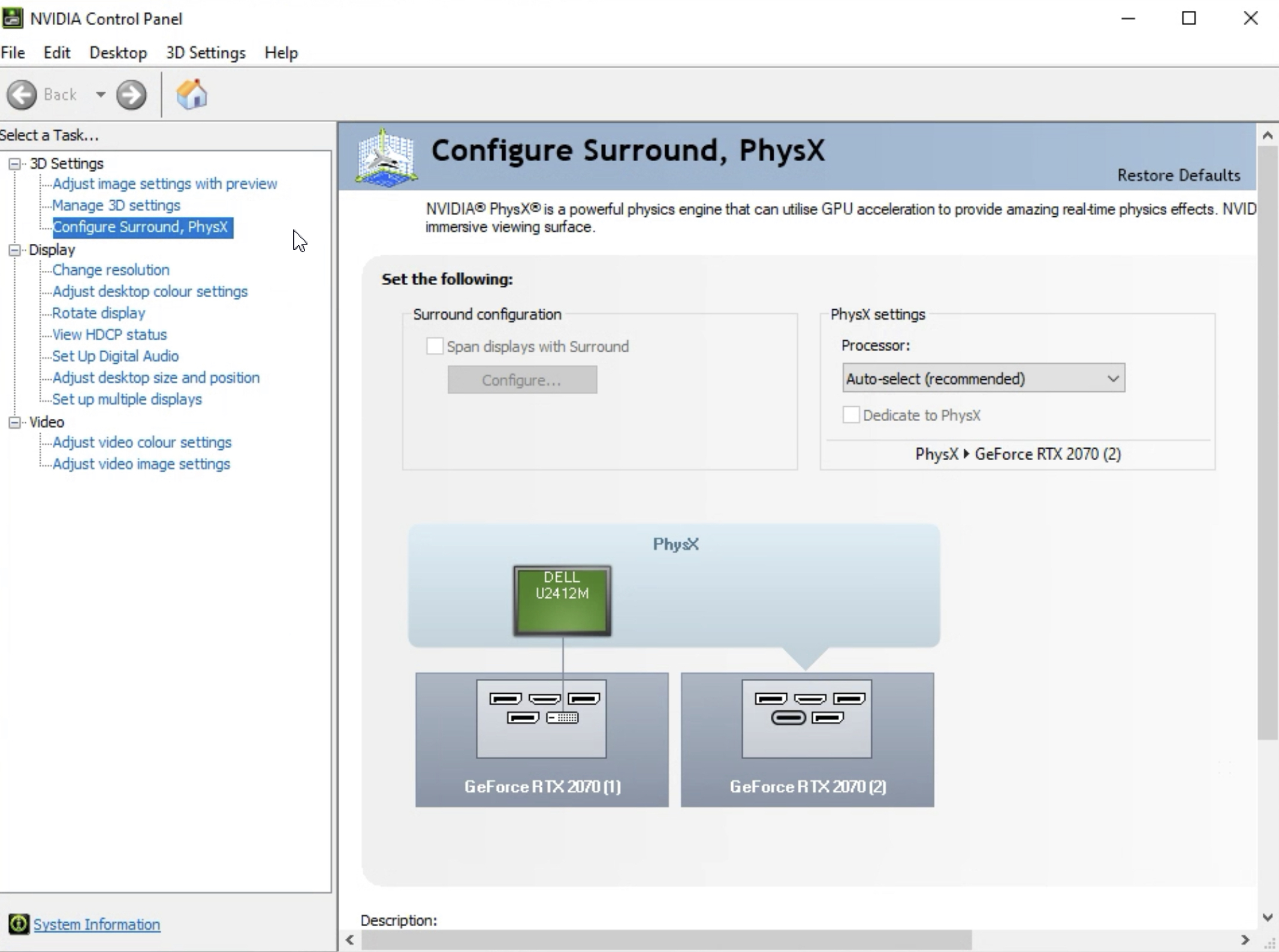

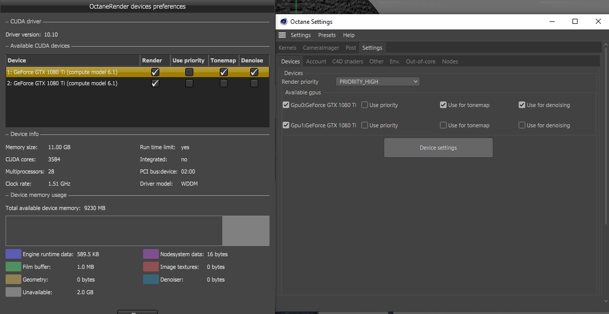

the Nvidia driver should be good, Studio 431.86, please post a screenshot of c4doctane Settings/Devices panel, and another one similar to this:

oh, i fount the driver: it's 431.86. I see, there is a new one 441.28, shoult I install it?

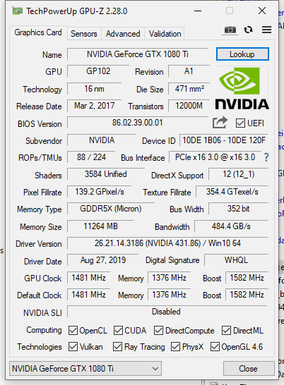

Please, download and run GPU-Z:
https://www.techpowerup.com/gpuz/
And share a screenshot from the Graphics Card tabs from both GPUs, thanks.
If it crashes with Tonemapping active, probably the PCI bus of the second GPU is too slow.
Please also post a screenshot from c4doctane settings/Devices panel, thanks.

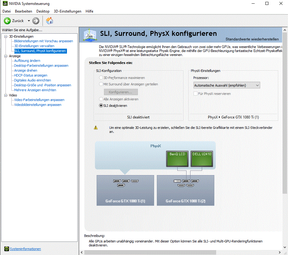

here some screenshots, thanks a lot!
Posts: 10555
Please, try theses steps.
  • Go to Nvidia Control panel, menu Help, and enable the Debug Mode, to work with GPUs at default clock.
  • Connect one monitor per GPU, to reduce the available VRAM more uniformly .
  • In Devices panel, enable the Priority for both GPUs, and set the Priority popup to LOW
ciao Beppe
