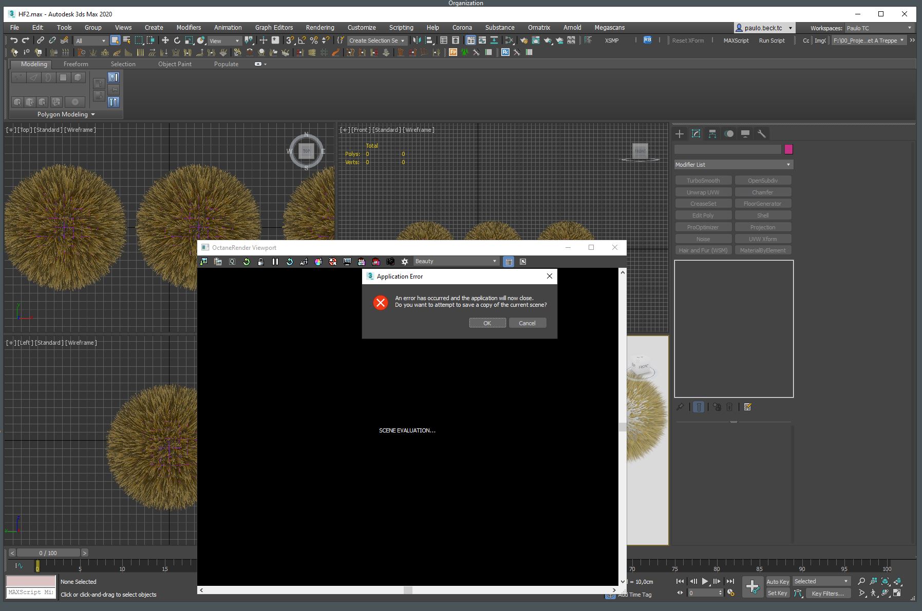

Instant crash with Hair and fur with v2018.1.3 - 7.13.
A simple sphere ( radius 0.5m) Hair and fur , rendering option "geometry" (in 3dmax effects settings), a sunlight. Open octane render viewport, and crash....

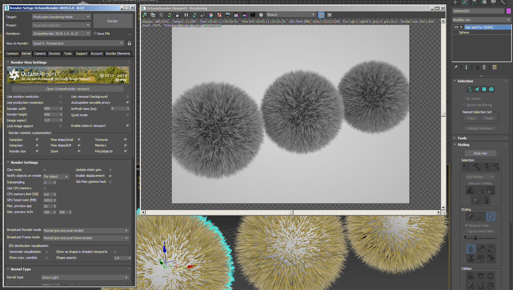

Hi guys,
H&F seems to works in V2018 and V2019.
Regards
Paride
HF2.rar
(465.73 KiB) Downloaded 193 times

Hair & Fur usually works, but doing several tests today, I'm experiencing some random crashes.
I am testing plugins versions v2019 - v2018 using 3dSMax 2020 - 2019 and 2018 release, then I will send a report to developers to figure out when these crashes occur.

Meanwhile, you could try to clear the texture cache (Octane Global preference > materials > clear cache)
and reset default preset (Octane Global preference > preset)
Regards
