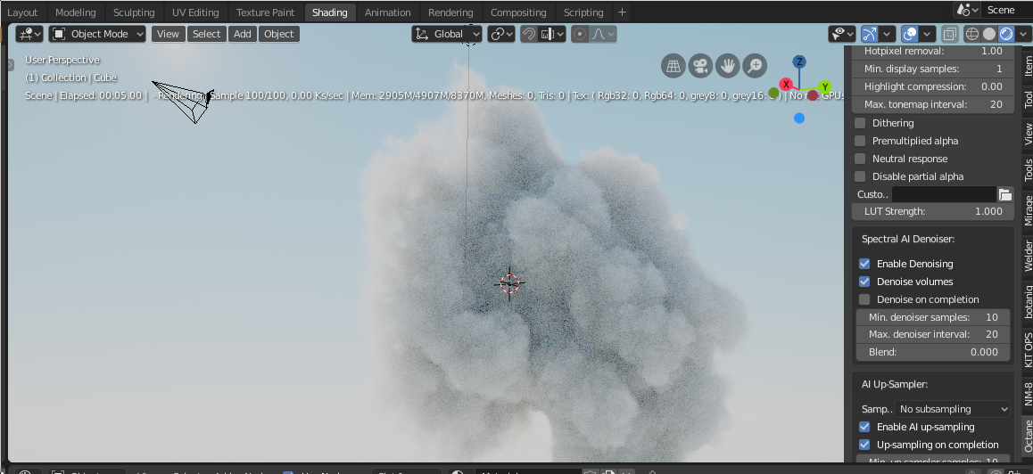

Here is the viewport view and settings:

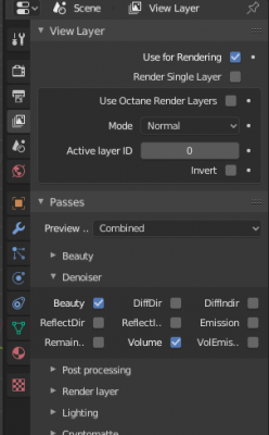

Here are the settings for the final render:

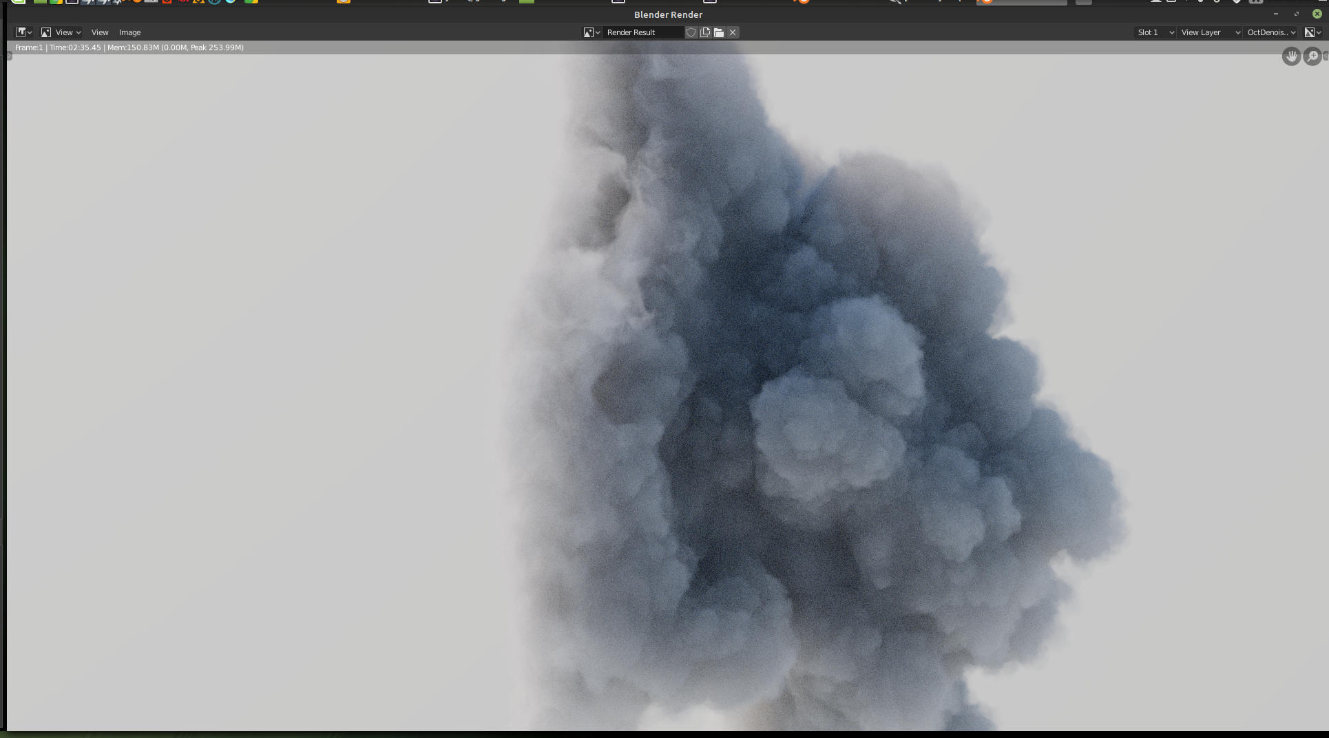

And here are the results after choosing the denoised volume image from the passes menu:

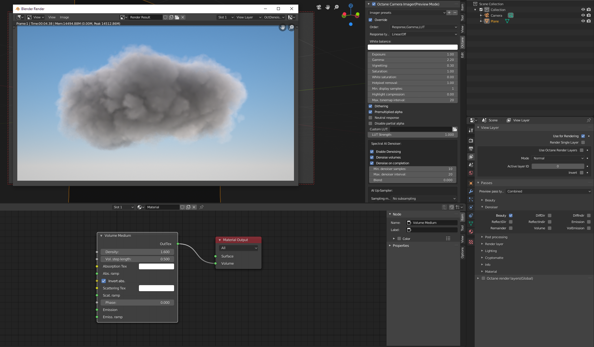

It works for me with these settings:

Looks like you unchecked "Denoise on completion" in Imager settings.

My confusion was that the "N" panel settings were only used for the preview and not for the final render (F12) in earlier versions. It's working now. :D It's nice that you no longer have to specifically set the denoiser for volumes.

The "N" panel settings will be used if the "Override" is checked.
