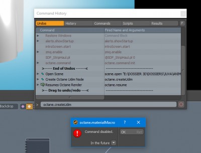

Hello,
I'm trying to load my UDIM maps with the history command (octane.createUdim), but after selecting my images I have this error message:
octane.materialMacro........ Command disabled
Maybe a Modo problem?
Does anybody have an idea?
Thanks a lot
Philippe

I'm using Octane 2019.1 and Modo 13.0

Same here. Is there a workaround?

Ok found it by myself. You can use a nodegraph and add a imagetiles node there to load the udim

Philippe - can you please send me the original UDIM teture files which would not load using the octane.createUdim command, and I will take a closer look.

I just got Octane 2019 today. I had the exact same problem. :cry:

OlaHaldor wrote:I just got Octane 2019 today. I had the exact same problem. :cry:
No one has yet sent me through any UDIM's which cause this issue, so I haven't been able to determine the cause of the issue.

I'm not sure why you'd need a udim set from us to test; create a few images with names like
albedo.1001
albedo.1002
albedo.1003
and so on. There's nothing special about the images.
I'm having this problem with Octane 2019.1.4
Please see the video attached.
2019-12-02 09-48-36.mp4
(3.46 MiB) Downloaded 3083 times

Hi. This issue will be fixed in the next release.
