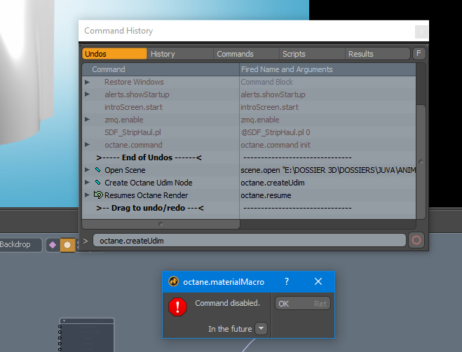

I'm trying to load my UDIM maps with the history command (octane.createUdim), but after selecting my images I have this error message:
octane.materialMacro........ Command disabled
Maybe a Modo problem?
Does anybody have an idea?
Thanks a lot

Ok found it by myself. You can use a nodegraph and add a imagetiles node there to load the udim
Philippe - can you please send me the original UDIM teture files which would not load using the octane.createUdim command, and I will take a closer look.

No one has yet sent me through any UDIM's which cause this issue, so I haven't been able to determine the cause of the issue.OlaHaldor wrote:I just got Octane 2019 today. I had the exact same problem.
Paul
I'm not sure why you'd need a udim set from us to test; create a few images with names like
albedo.1001
albedo.1002
albedo.1003
and so on. There's nothing special about the images.
I'm having this problem with Octane 2019.1.4
Please see the video attached.

Hi. This issue will be fixed in the next release.
Paul
