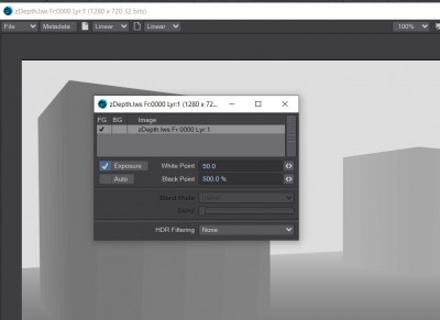

Hmm, are you sure you uploaded proper scene ? your scene don't even have Passes/Z-depth ON ? There is only Beauty channel active and no passes node and you used infochannel kernel ? Why not using PT kernel and then passes node for Z-depth into EXR?
You should connect passes node and activate z-depth and then if you want to use it in Photoshop you'll have to normalize it, otherwise it'll be all white (PS sucks with 32bit files). Open image in PS and do HDR Toning in to tweak white/black levels, like this:
http://prntscr.com/pqv5l9

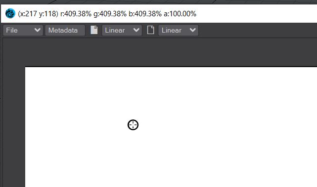

It is perfectly white because it stores floating distances far away 1 unit. You can check it yourself even in the LightWave image viewer picking over any pixel in the image to see that the values are usually greater than 1.0. Be aware that a z-depth image is not designed to see anything, it stores the distance from the camera to the objects in each pixel ... of course, you can always tone map the image, but then the distances are destroyed.
Thanks,
-Juanjo
Thanks,
-Juanjo

Thanks - I was trying to make it work with the infochannel kernel because I can crank out any pass I need for a project that way very easily, and they do work, except Z Depth. It seems like it should, since it looks like I want it to in the IPR and render progress window. If you try the IPR in my test scene, it looks correct.Lewis wrote:Hmm, are you sure you uploaded proper scene ? your scene don't even have Passes/Z-depth ON ? There is only Beauty channel active and no passes node and you used infochannel kernel ? Why not using PT kernel and then passes node for Z-depth into EXR?
- GimbalLocked
- Posts: 13
- Joined: Mon Mar 26, 2018 12:41 pm
Thanks. I think this makes sense. I've been using Z Depth as an alpha mask for layers etc, ranging from 100%-0% black.juanjgon wrote:It is perfectly white because it stores floating distances far away 1 unit. You can check it yourself even in the LightWave image viewer picking over any pixel in the image to see that the values are usually greater than 1.0. Be aware that a z-depth image is not designed to see anything, it stores the distance from the camera to the objects in each pixel ... of course, you can always tone map the image, but then the distances are destroyed.
Thanks,
-Juanjo
I'm confused by the IPR and render result not showing the same.
Sure but you are rendering scene twice that way - PT kernel and then infochannel kernel, while you can do all of those in one pass with multiEXR and render pass nodeGimbalLocked wrote: Thanks - I was trying to make it work with the infochannel kernel because I can crank out any pass I need for a project that way very easily, and they do work, except Z Depth. It seems like it should, since it looks like I want it to in the IPR and render progress window. If you try the IPR in my test scene, it looks correct.
