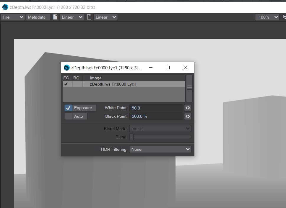

juanjgon
Posts: 8867
Location: Spain
It is perfectly white because it stores floating distances far away 1 unit. You can check it yourself even in the LightWave image viewer picking over any pixel in the image to see that the values are usually greater than 1.0. Be aware that a z-depth image is not designed to see anything, it stores the distance from the camera to the objects in each pixel ... of course, you can always tone map the image, but then the distances are destroyed.
Thanks,
-Juanjo
2019-11-01 19_17_48-zDepth.lws Fr_0000 Lyr_1 (1280 x 720 128 bits) 0.0 seconds.jpg
