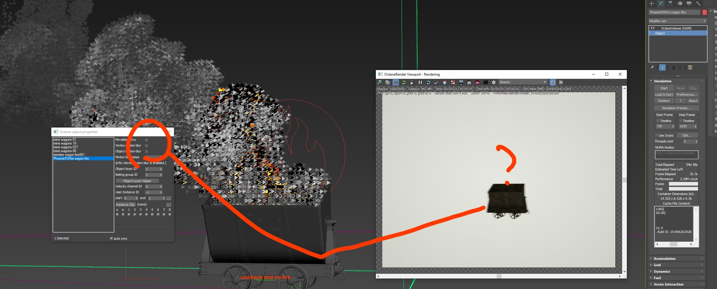

Hi Paride,
I got 3 problems with phoenix and octane:
1. If you enable movable proxy and motion blur octane will not render fire mb the right way. (velocity channel was checked in phoenix during sim) Do I also need to output SPEED channel?
2. Then if you close octane viewport and uncheck movable and mb and go back to octane viewport you will see no fire until max is restarted. So hiding volumes bug is still here

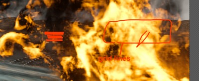

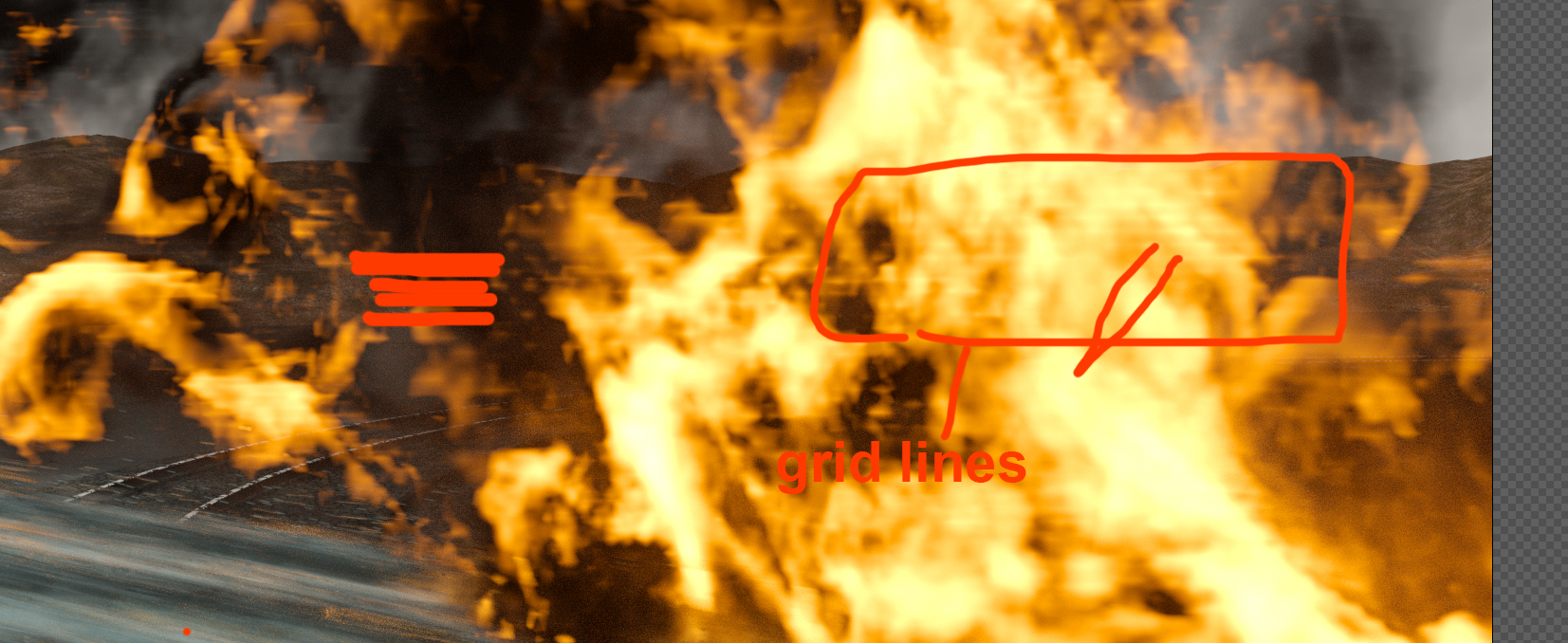

3. Octane renders flames as tiny horizontal lines. Chaos said it can be octane problem. Vray renders flames very smooth

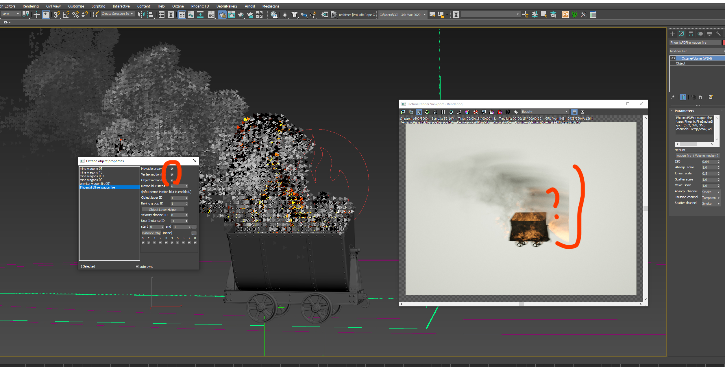

Hi Paride,
the 4th bug is octane is not rendering red phoenix particles. The scene is attached

Hi coilbook,coilbook wrote:Hi Paride,
yes, I also found and sent this issue to developers last week.
Regards
Paride
