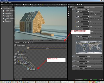

I am using version pre beta 2.3 v5, and do have few problems with it.
Don't have sixth dot to plug in RenderTarget into my obj file.
Is there any other way to create multiple rendertargets in this version?

neoone wrote:I am using version pre beta 2.3 v5, and do have few problems with it.
Why on earth would you still use that ancient version ?
You should upgrade to 2.52 asap, it's a world of difference feature-wise.

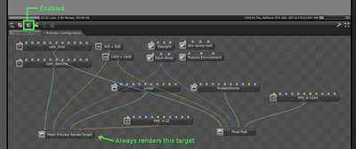

Does render target switching work in 2.52? Because I have this setup below and nothing happens if I click on the render target node that I created. The default one is always rendered, although the parameters in the NI change accordingly to selected render target.

Hi Matej,
You need to connect the object node you want to render to the last input pin of the render target node. The mesh preview render target is a special case, these settings are used if you preview a mesh node, a material or a texture.

Yes, that makes sense :) Thanks!
I hope one day we will have a generic container node, so all that render config nodes can be put there and not additionally clutter the top panel (which usually contains material macro, mix & texture nodes). And an input pin to pass the mesh node into it.
