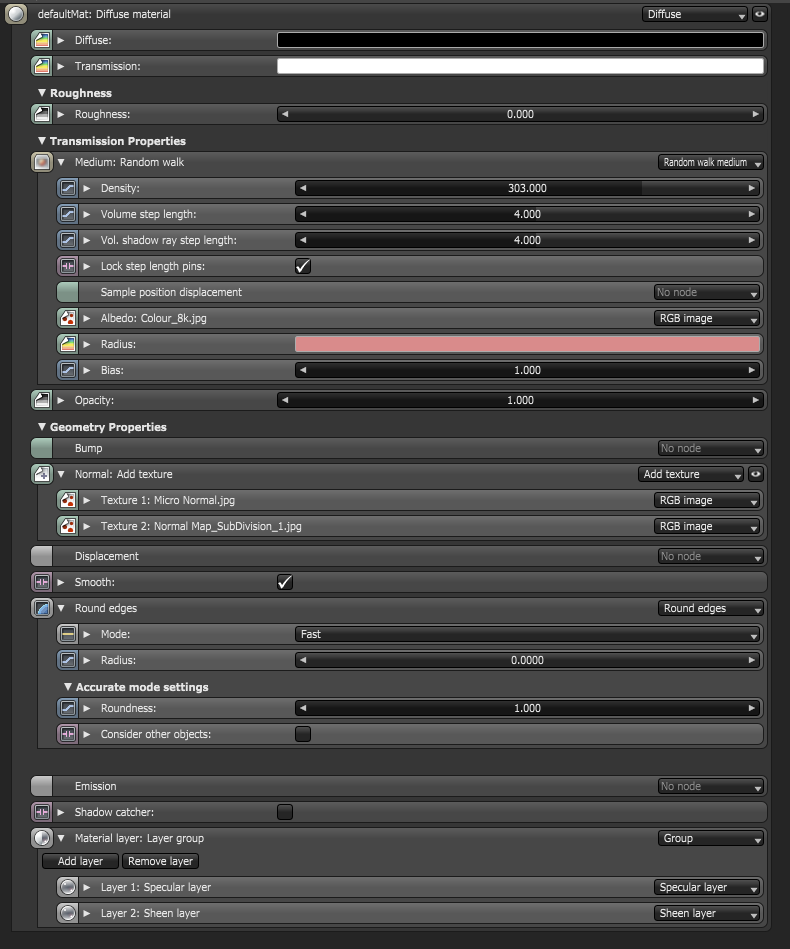

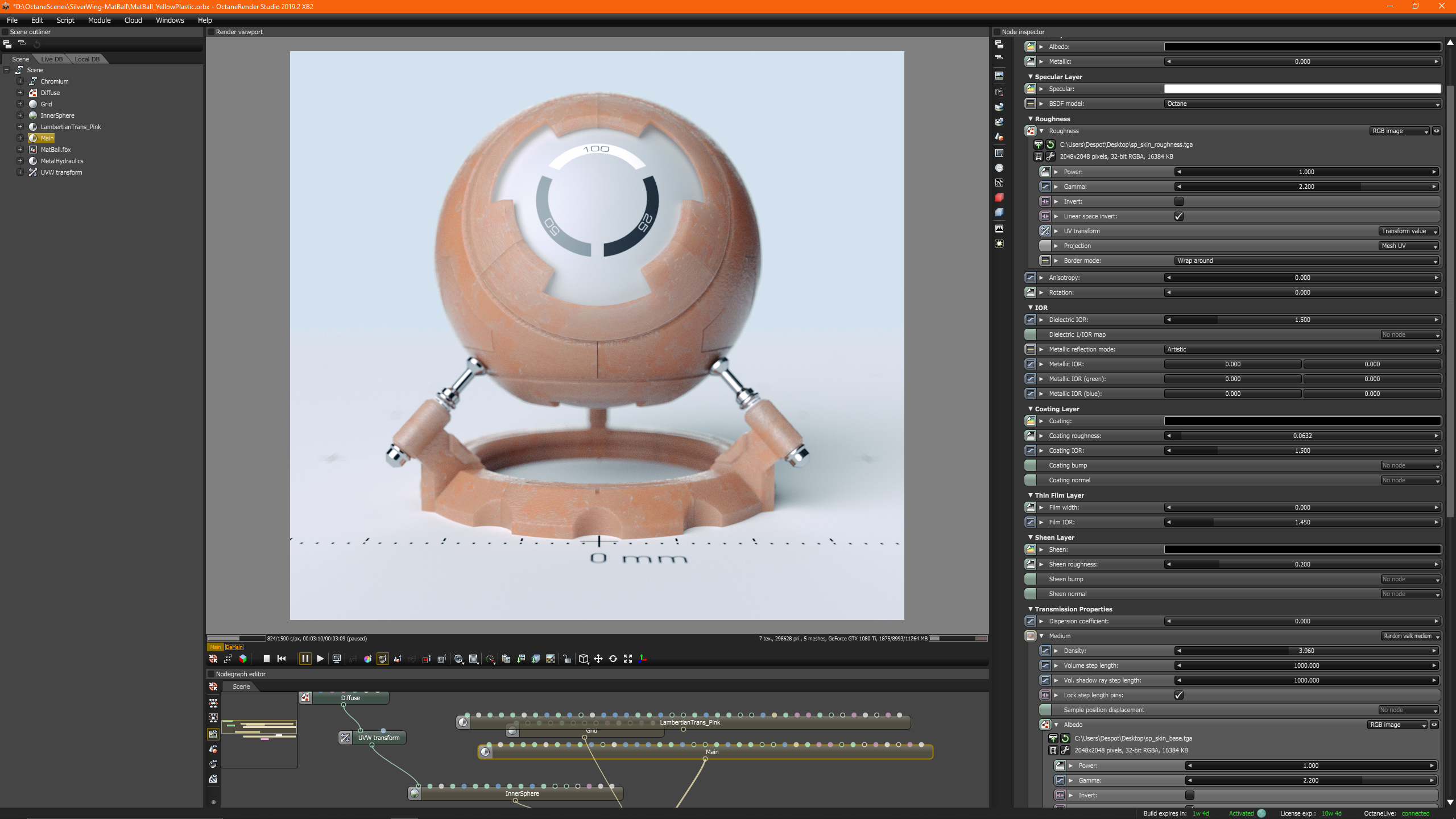

Works for me, just make sure your albedo is set to black... see screendump.
Hope this helps...
J

Have you increased medium density? Here are some of my experiments I did earlier where it is set to around 300-400:

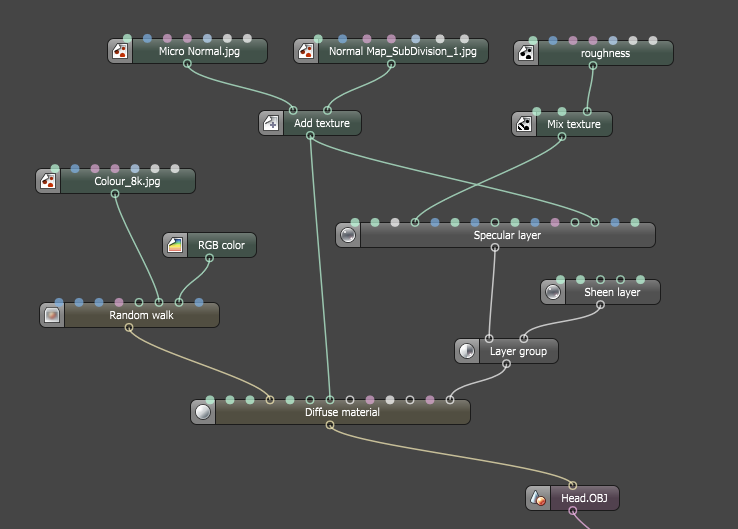

Cool renders - would you be able to post screendumps of the settings you have for the shader, I'm specifically wanting to know if you are using a map to control 'radius' or are you using a colour ?

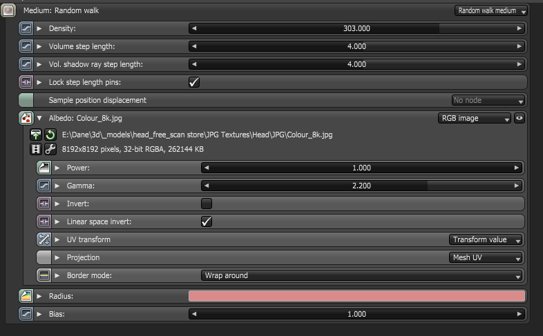

Sure, here is my material setup:
Material:
Medium details. Here I'm using color for radius:
Diffuse details:

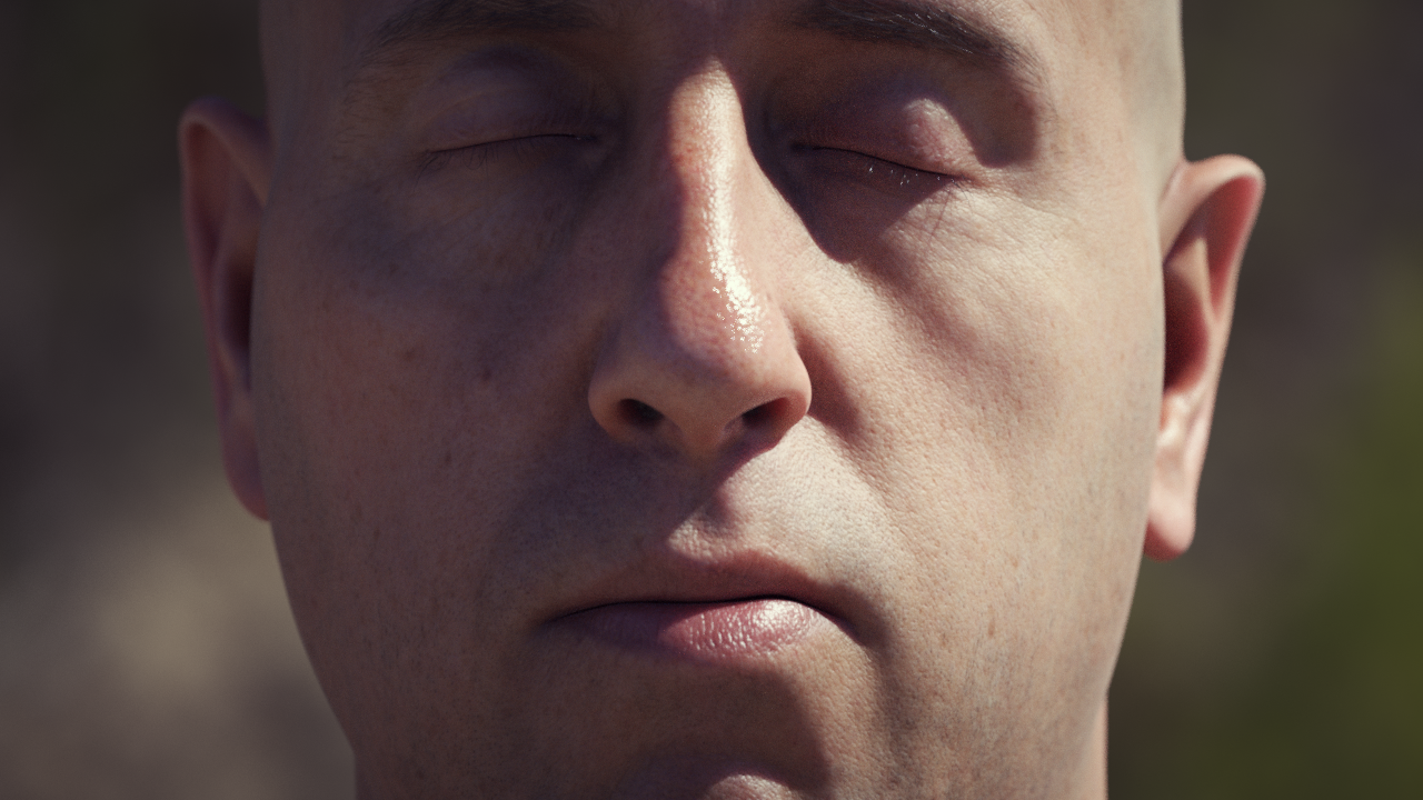

I am pointing this out in the main Dev Build forum now, there are many issues in using this technique, especially if your body has multiple textures:
1) Using to high saturation in Radius causes Hot pixels
2) Leads to a simultaneous 'darkening' of the underlying Albedo edges, making it look like a pencil-line between textures
3) Renders black in Daylight kernel mode (in other words, is completely dependent on Path Trading)
It's a shame really, because it responds excellent to HDRI lighting. Much better than 'regular' Transmission use does.
Just too many side effects ruin it.
For a single Bust mesh with closed eyes, though, is awesome on skin.
But with open eyes, no good
