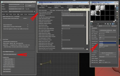

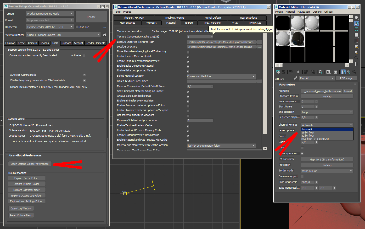

Hi justix,
Autosave doesn't depend on Octane, you can disable it: 3dsmax > File > preferences > File > uncheck "enable".
Cpu memory feature (Octane V2018.x and V2019.x) lets you use more textures and geometry (not geometry only) than would fit in VRAM by keeping them in RAM instead; this feature increases and any RAM occupied with cpu memory data will not be available to other applications. This means would be recommendable have sufficient RAM, personally I recommend minimum 64 GB.
You can optimize DXTC textures in RGB texture node.
Ram is the reason for the tests you did, 3dsMax needs RAM then Octane also needs RAM. So you have less RAM if you only use Octane Standalone instead. Furthermore OctaneRender Standalone does not use opengl so it also needs less resources.

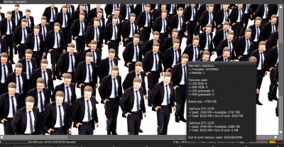

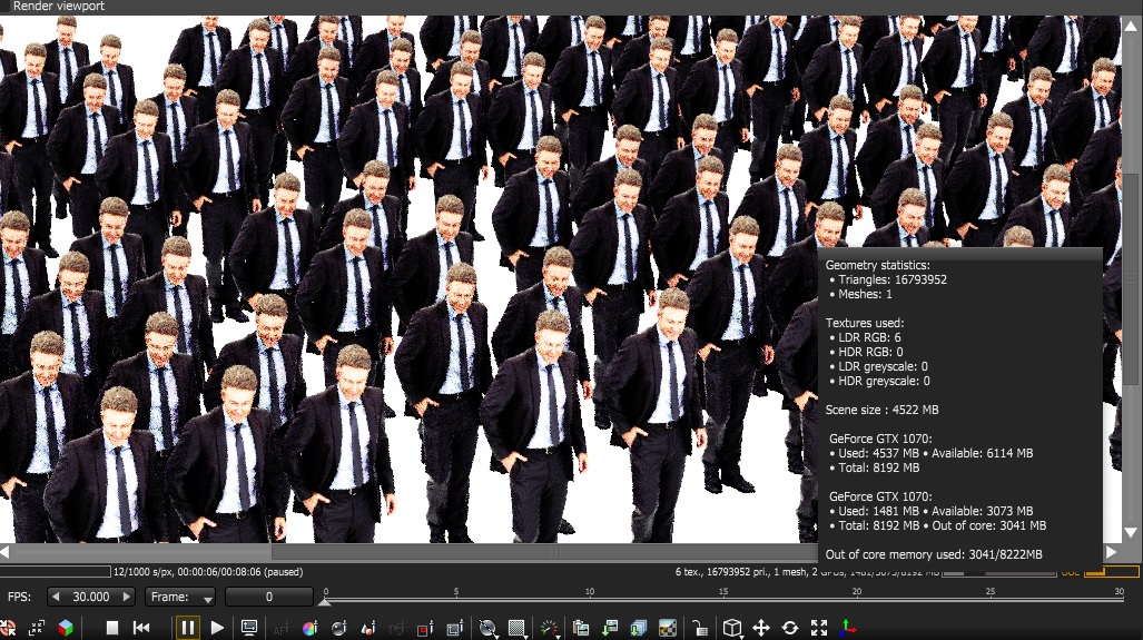

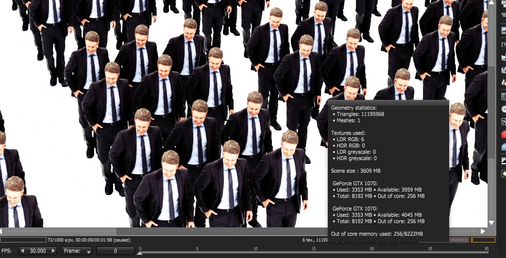

Hi Paride.
I know I did open a similar thread a long while ago but I'm on V 4.05 - 6.21 and can't test 2018-2019 as on a STAND SUB T3 and so I'm stuck I presume, I'm fully aware of all RAM problems ect and my issues are concerning also the difference between plugins and..plugins, I get that OTOY is relying on a Out of Core solution for the geometry + texture VS Vram instead of a sort of optimization like I see elsewhere ( Centileo for example is claiming 750M unique polygons for 10GB GPU memory and tested with 15 Mil Triangles on my 8GB 1070 and did not even hang a bit eating it up in 20 sec.. on my max 2016.. I mean not standalone ).
But at least on 4.05-6.21 the CPU Out of core set at 8GB makes no difference at all..it takes more than 60 seconds to load geometry ( 11Mil Triangles ) an then freezes up while I guess the CPU out of core option should take care of the extra geometry?
Please try to read my passion for it...because we all love to have a competitive system somehow... I take the chance to leave a little test here so that anyone with 8gb card can test it and report if they would... like 7 Mil Triangles or copying the msh up to 10-15 Mil and report back? Is there a Table that we can use to understand how Octane is handling UP TO ( only Vram ) in terms of Polycount? would benefit I guess....
On the positive Notes the SA 4.05 is handling that test well so far.. But again I think ( MHO ) that the plugin need to be optimize to say the least OR I don't undertand why 3Dsmax should eat my Vram instead of the CPU?
PLUS differences between the 4.05 SA with a 16 Mil scene and the 2019 1 RC5 SA the 2019 eems to use less Vram memory compared to 4.05
