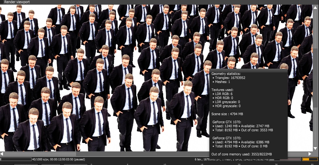

PLUS differences between the 4.05 SA with a 16 Mil scene and the 2019 1 RC5 SA the 2019 eems to use less Vram memory compared to 4.05
Memory Used 1481 Avail 3073 Out of Core 3041
Memory Used 1240 and Avail 2747 (??) Out of Core 3553
