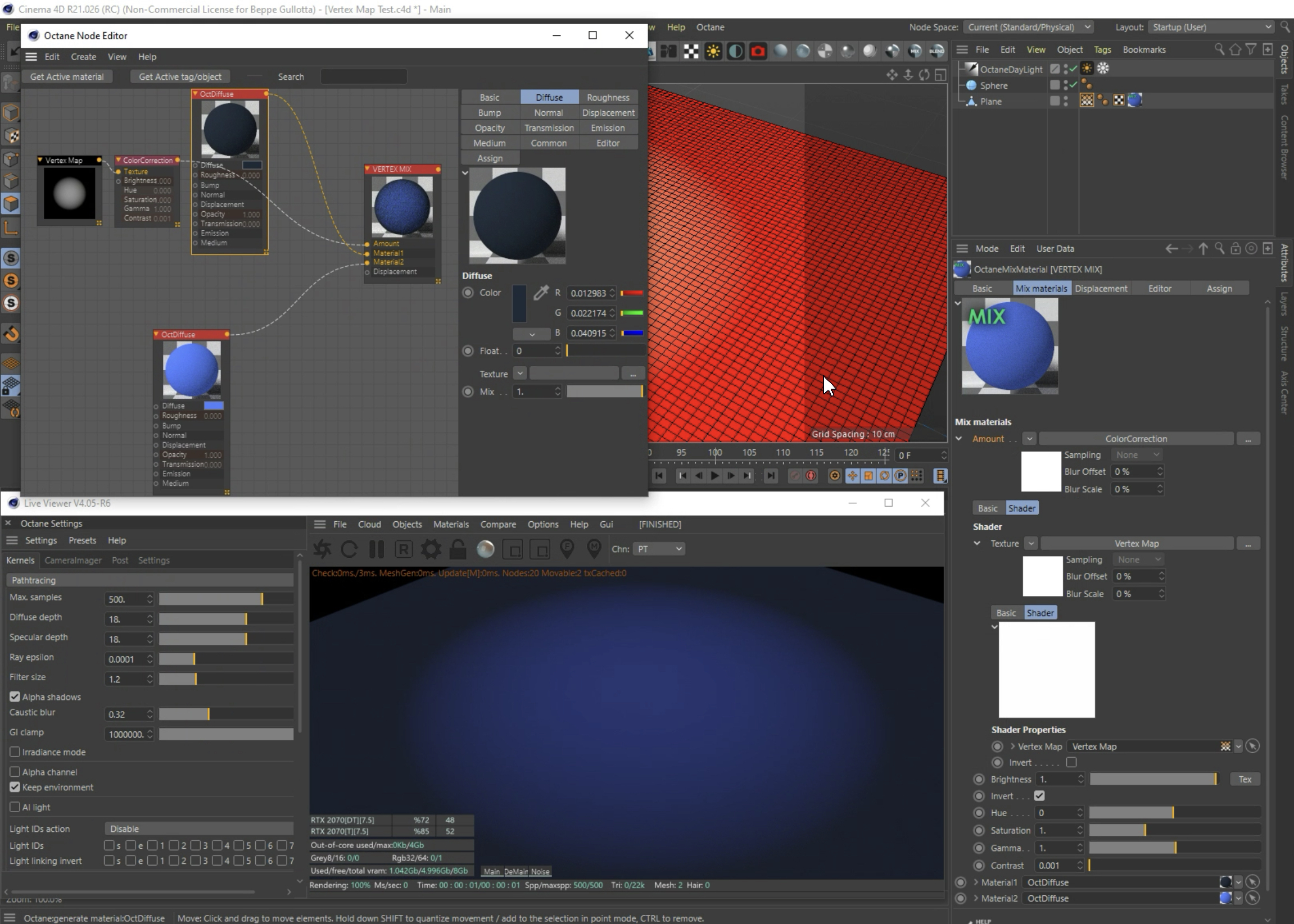

everything is working as expected here with your scene:
Since you have a Titan X Pascal under Win 10, please, perform a clean installation of 431.86 Nvidia Studio driver:
https://www.nvidia.com/download/driverR ... 1050/en-us
To perform a clean installation, please follow these steps:
ciao Beppe

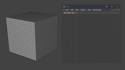

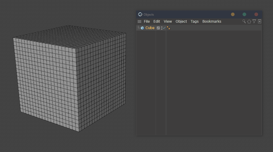

This is still happening, I've tried on 2 machines now this one being the OP machine that has 2xTitan X Pascal and then my home machine which has 3x1080ti's and the same version of Octane 4...Exact same error.
Me showing steps of consistent crash.
I've tried reinstalling Nvidia drivers too, clean install...However, there are literally no other issues with Octane so how can this be a driver issue? I can work hours with Octane no problem, just when using the vertex map I get this issue literally every time no fail on 2 completely different machines...
Octane 4 has kinda been left and 2018/19 being worked on so do you think this could be a bug in the Octane 4?

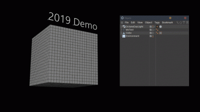

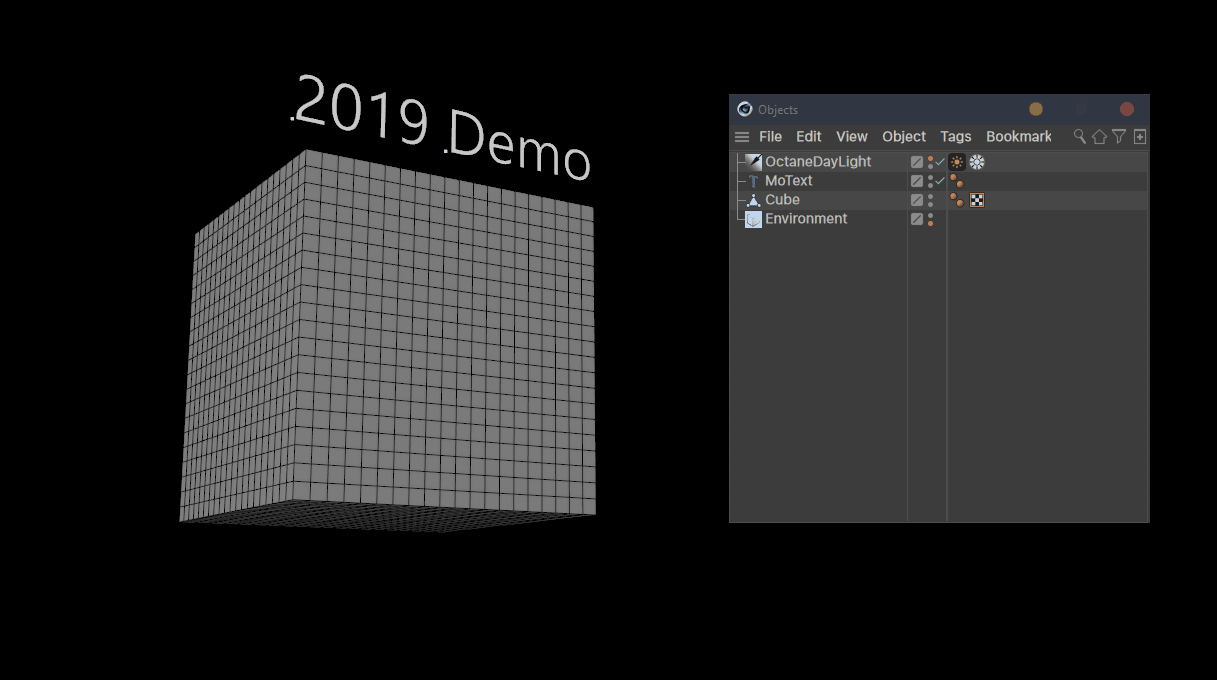

2019 Demo....Works without ANY issue everytime..
Click to view gif
Click to view gif
Maybe I'm being forced to upgrade?
