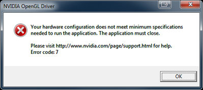

I've been rendering for 12 hours now when all of a sudden I got an error from the OpenGL driver. 12 hours completely wasted :cry:
Anyone got an idea what might have caused it? When it crashed I was just doing a bit of modelling in Blender whilst the render ran in the background.

I've just got a new monitor so maybe driving 2 monitors is pushing my 8800 just too much. Odd that Octane crashed though because that was running on my 460 card.

steveps3 wrote:I've been rendering for 12 hours now when all of a sudden I got an error from the OpenGL driver. 12 hours completely wasted :cry:
Which version did you use?

steveps3 wrote:As I mentioned in my post, I was modelling in blender when it crashed. I have rerendered overnight using 2.47 and all seems fine. All except there is still a lot of grain so I will have to leave it rendering some some. Maybe a couple of days.
What is your display card, how much memory does it have and did you work on a big mesh in Blender? Which graphics cards did you use for rendering in Octane?
Do you think there is a way to reproduce this problem?
When you re-rendered the scene in beta 2.47, did you do some modeling in parallel?

in his sig it says an ECS 8800GT.
has 256mb vram or 512mb with a BIOS update apparently.
see here
http://www.overclockersclub.com/reviews ... 0gt/14.htm
further up it says he is using 2 monitors and a GTX460 for Octane.
at a guess I would say the 8800 is not ideal for 2 monitors for win7 + modelling if it is 256mb.
might want to consider flashing the BIOS to 512mb or upgrading to a card with say 1gb or even better a Quadro 600 (not expensive - good CAD,DCC performance).
alternatively perhaps there is a minor heat/stability issue after a prolonged period?
another thing that crossed my mind is if there is a screensaver set after an idle time that messes up the openGL?
