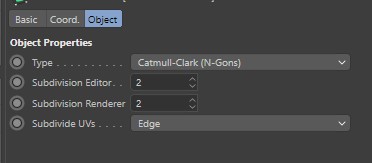

Hi, If you are using Sds to smooth your geometry make sure that the subdivide Uv is set to edge, if not stretch like that happen.

if is not that, check the projections in the object manager for your material, or the projection node in your octane material textures if it exist. and make sure that are set to mesh uv and/or uvw mapping projection

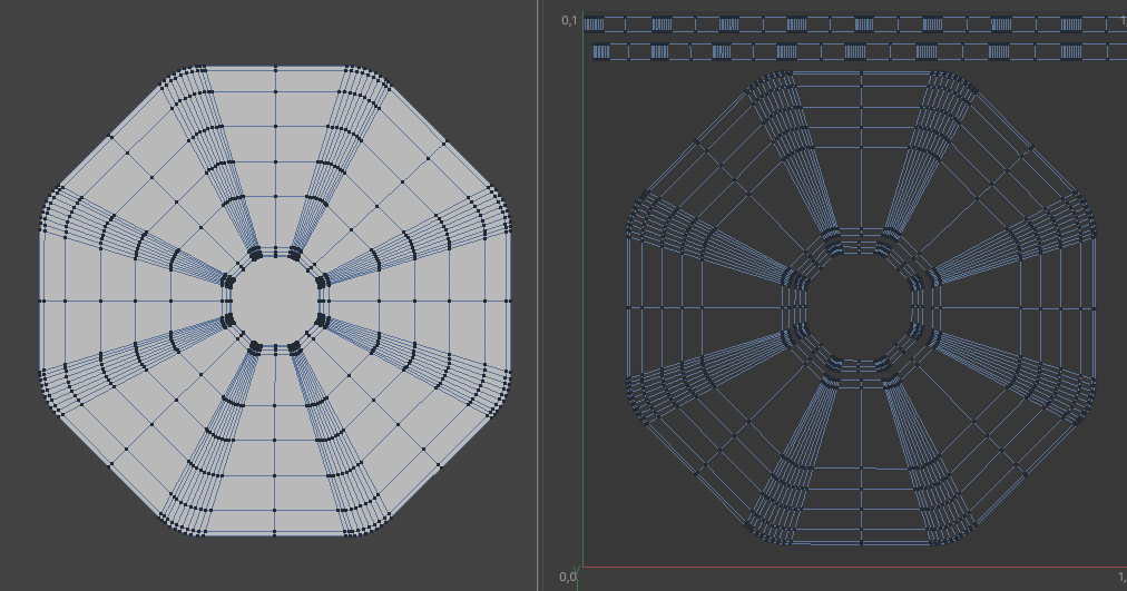

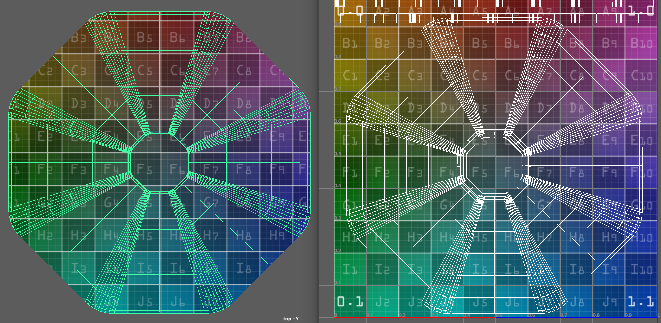

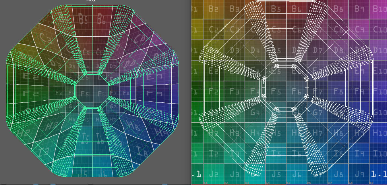

Compare your actual geometry to your UV space. Notice how your poly rings are evenly spaced, yet in your UVs, they are clustered closer to the rim. You need to adjust, or probably more simply, re-project your UV mapping so that you are not introducing distortion.
The distortion you are seeing.
Your current Polys on Left, UVs on Right. (No texture for the sake of clarity.)
1:1 Polys to UVs, no distortion
