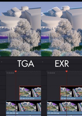

I use .tga for all my stills and movies.... old guy....
I'd like to use a "better" format to keep more infos to import in resolve.
But all format except .tga I have an ugly alpha cutout.
Anybody can give me some advises ? Thanks.

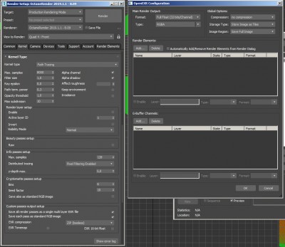

Hi HHbomb,
try uncheking "keep environment" in Kernel panel.
Regards
Paride
HHbomb
Posts: 1435
Hi, Paride. Allready unchecked.

yes. With .tga I have a very good alpha... even in out of focus,....

Hi, psd looks fine, .exr not.

could you share your render settings, kernel settings, camera settings ,.... and save file settings ? so I can compare :-)
