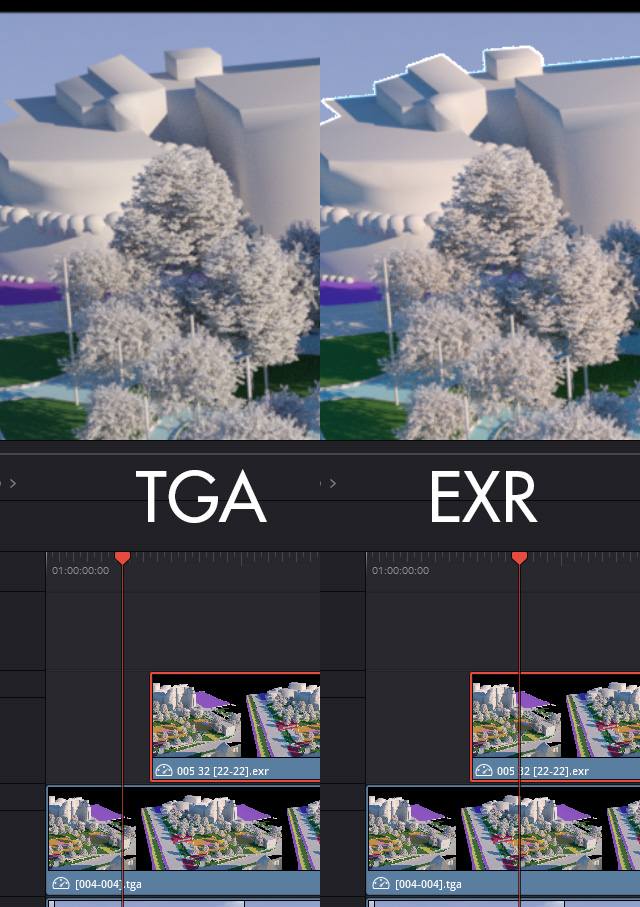

I use .tga for all my stills and movies.... old guy....
I'd like to use a "better" format to keep more infos to import in resolve.
But all format except .tga I have an ugly alpha cutout.
Anybody can give me some advises ? Thanks.

yes. With .tga I have a very good alpha... even in out of focus,....

Hi, psd looks fine, .exr not.

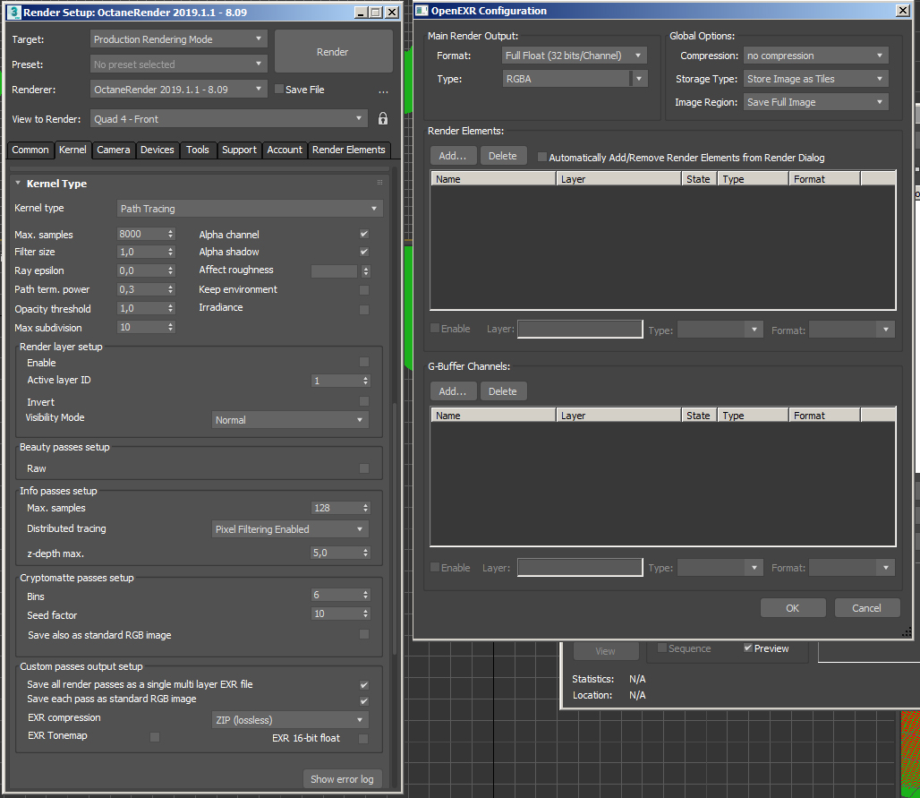

could you share your render settings, kernel settings, camera settings ,.... and save file settings ? so I can compare
