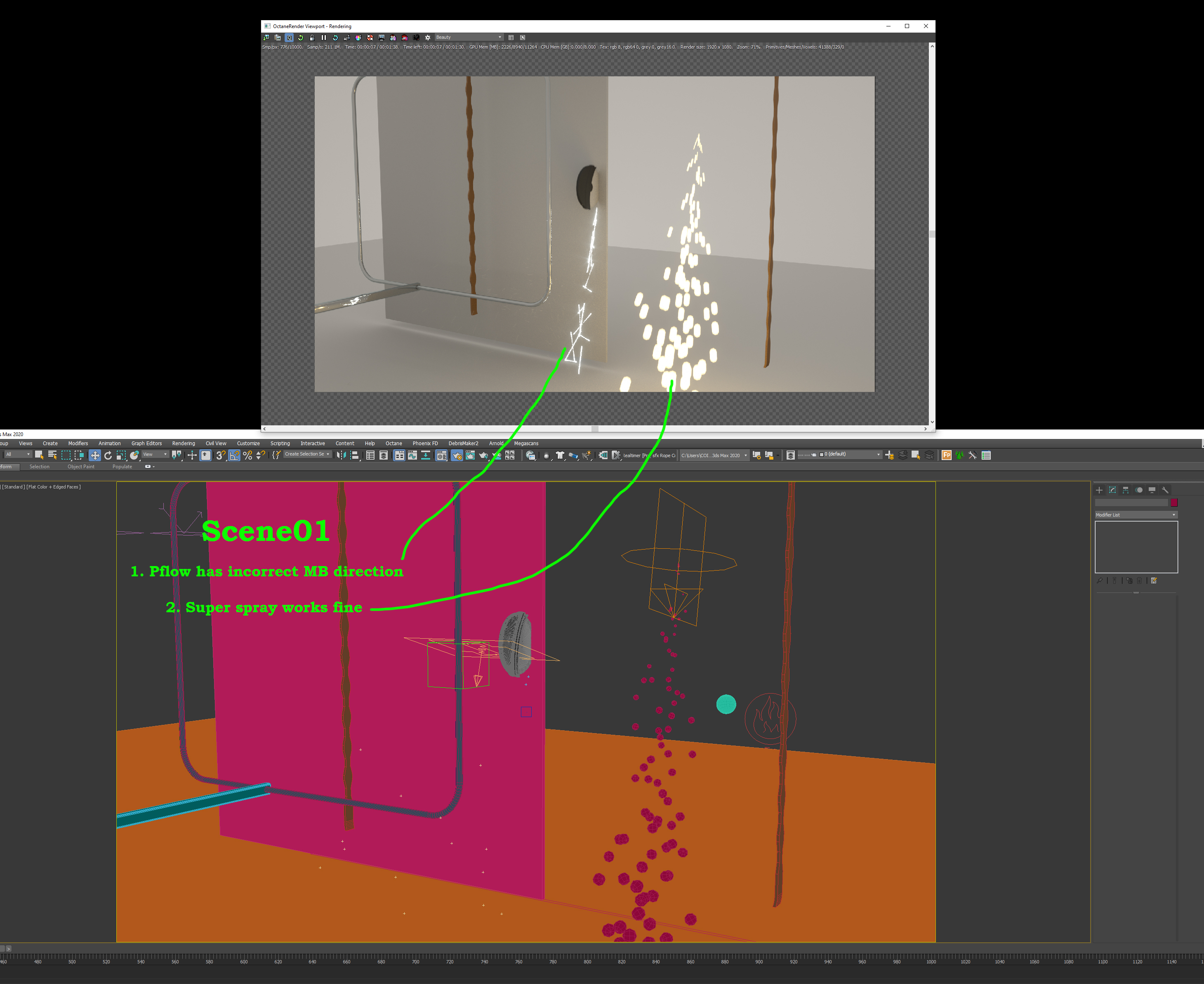

A. Scene01 - Pflow motion blur has wrong directions. Super spray works fine. If you go to Pflow events, then choose octane properties and turn off movable proxies and MB - particles will disappear. If you check the boxes back Max can just crash.

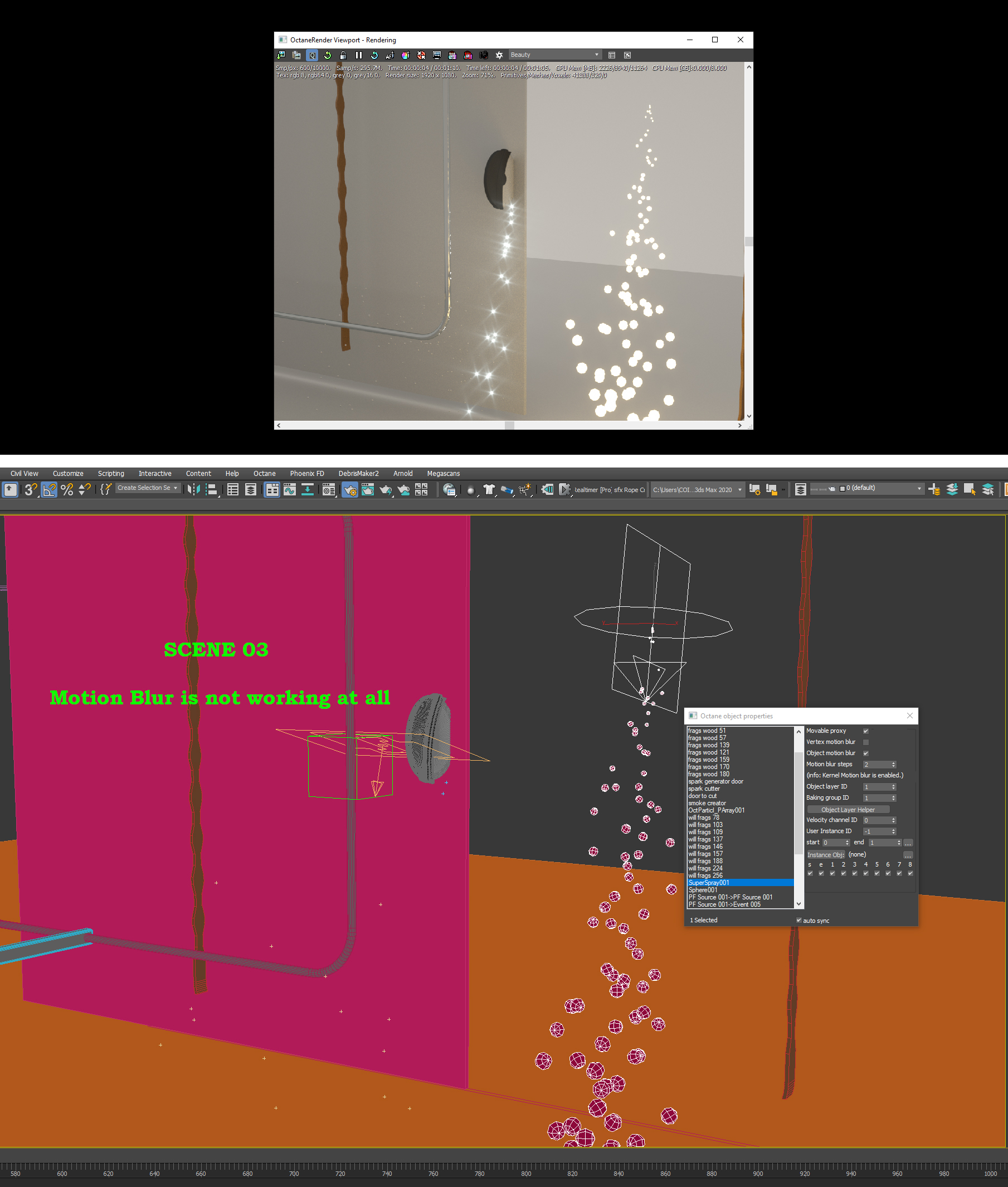

C. Scene 03 motion blur just does not work at all even though it is enabled. BUT if you merge an object as xref objects motion blur can start working again. (similar problem with the scene i sent to you with bricks not having mb)

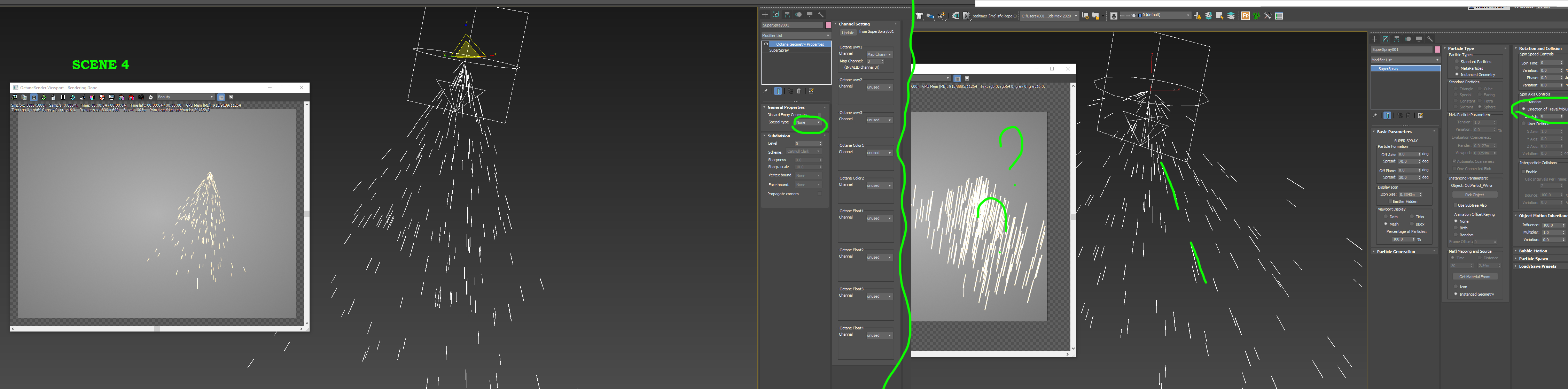

D. Scene 4 Super spray has no motion blur enabled but octane is not rendering lines the same way what viewport shows. In octane viewport sparks dont fly the same direction. Adding octane modifier can fix the problem but sometimes it just doesn't work during normal rendering. It seems that octane modifier only works when rendering starts during particle emission not before. Something is not getting updated or octane doesn't find out about the modifier during rendering.
Plus in octane mod special type must be set to NONE for proper particle travel instead of 'Extended geometry' (but developers said Extended geometry posting.php?mode=quote&f=80&p=359157)

For Scene 01, the incorrect direction comes from not having or not using velocity..
