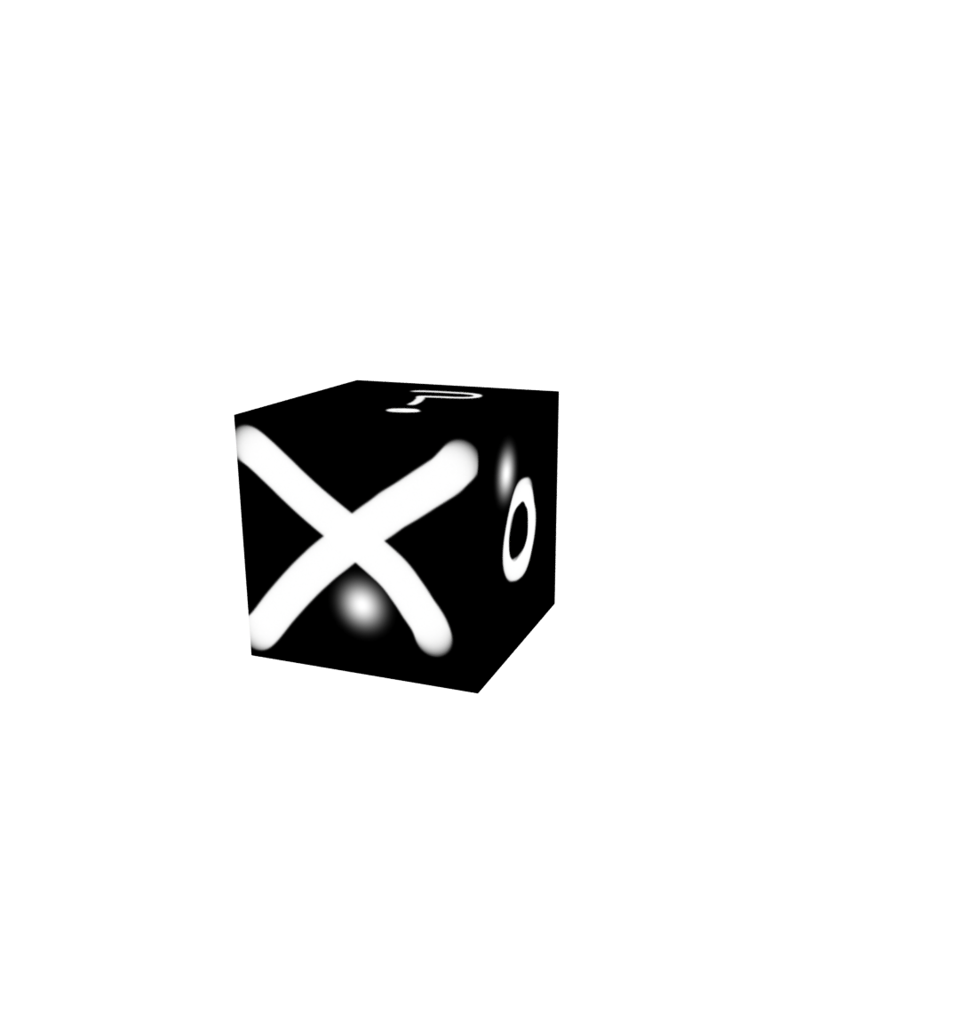

H. Hello, the Universal Material is not showing the Transmission or Transmission filter Info channel passes in 2019.1. I have used the same shader with a regular Octane Material and it works, but not when it's used with a Universal.
Here is the Transmission pass with an Octane Material:
A Universal Material is blank.

Thanks for the report.
Currently there is a “Transmission Type” popup menu missing, that must be set to Diffuse for transmissive materials, and will be added in the next version.
ciao Beppe
ciao Beppe

Thank you for the update!bepeg4d wrote:Thanks for the report.
ciao Beppe
