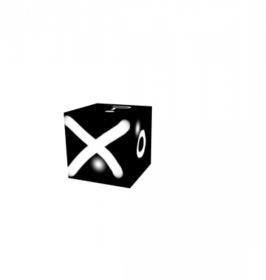

H. Hello, the Universal Material is not showing the Transmission or Transmission filter Info channel passes in 2019.1. I have used the same shader with a regular Octane Material and it works, but not when it's used with a Universal.
Here is the Transmission pass with an Octane Material:
Transmission pass with Octane Material
A Universal Material is blank.

Thanks for the report.
Currently there is a “Transmission Type” popup menu missing, that must be set to Diffuse for transmissive materials, and will be added in the next version.
