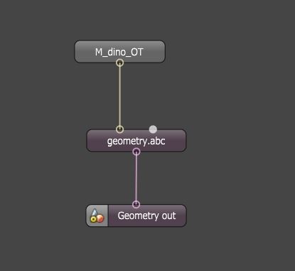

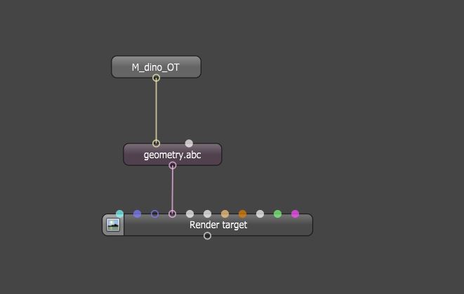

Have you tried to import the .orbx file once it has a geometry output or a render target node as the final root node?
Thanks,
-Juanjo
2019-09-23 21_48_55-_C__Users_juanj_Downloads_trex_08.orbx - OctaneRender Enterprise 2019.2 XB1.jpg
2019-09-23 21_48_55-_C__Users_juanj_Downloads_trex_08.orbx - OctaneRender Enterprise 2019.2 XB1.jpg (10.81 KiB) Viewed 6384 times
2019-09-23 21_48_41-_C__Users_juanj_Downloads_trex_08.orbx - OctaneRender Enterprise 2019.2 XB1.jpg
2019-09-23 21_48_41-_C__Users_juanj_Downloads_trex_08.orbx - OctaneRender Enterprise 2019.2 XB1.jpg (7.68 KiB) Viewed 6384 times

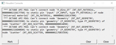

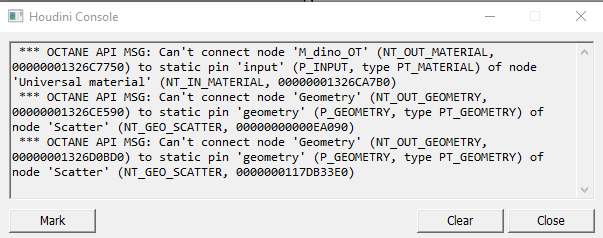

I have try both of your solution but none of them work.
I have the following error message :
Are you sure that it is not related to an Indie License restriction that doesn't allow orbx access ?
I have attach the orbx scene. It does work smoothly in standalone but not with the Orbx SOP.

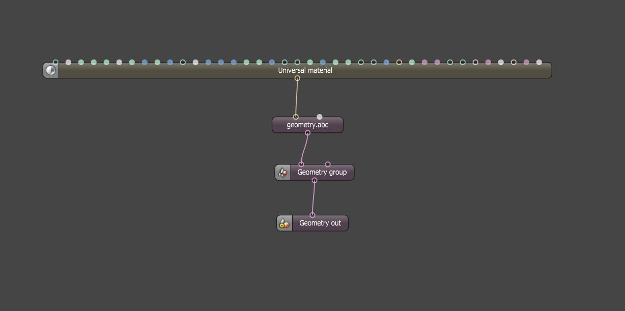

Hmm, somehow an alembic node can't be connected directly to the internal node tree built by the plugin to support the .orbx files. I'll investigate it, but meanwhile, a workaround is to add a geometry group node to the .orbx file.
Thanks,
-Juanjo

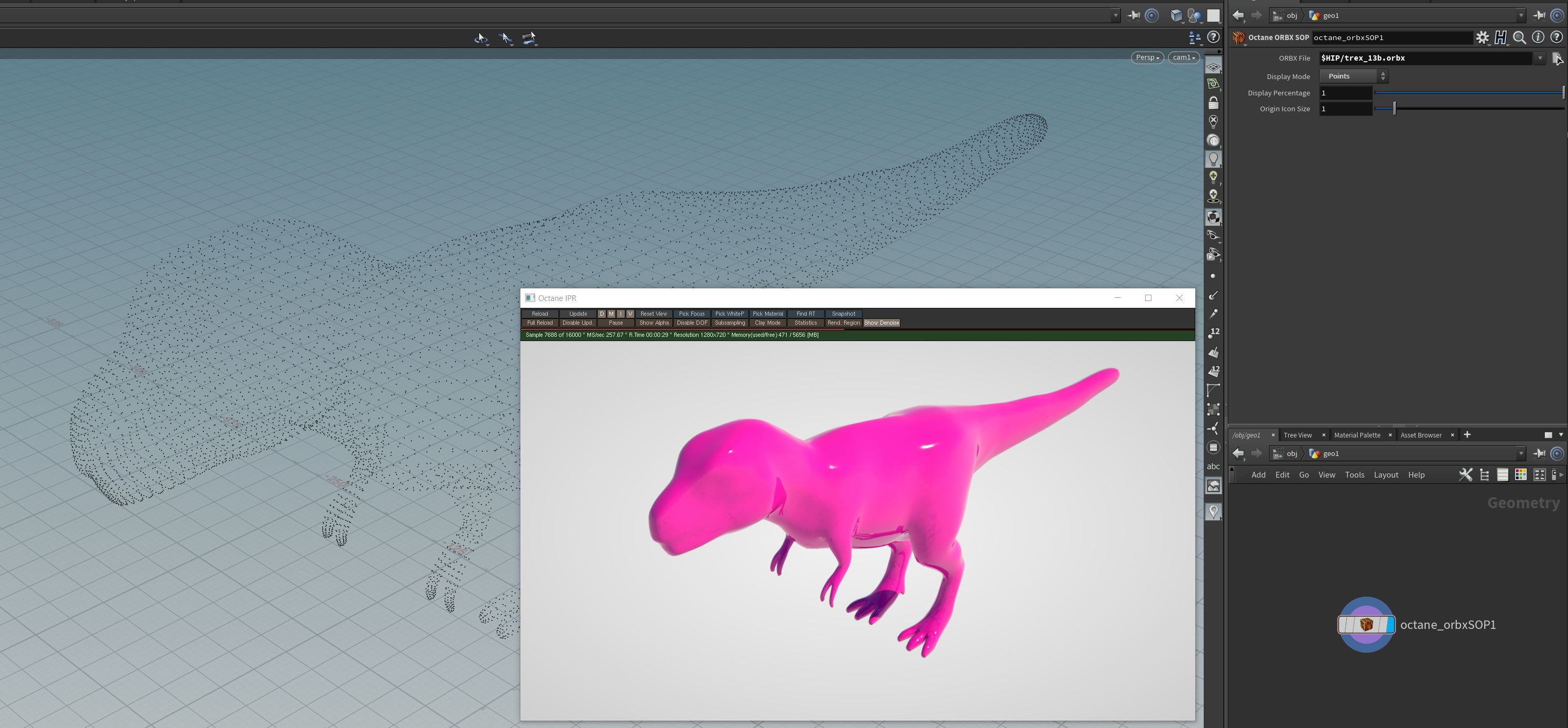

fantome
Posts: 269
Joined: Wed Dec 16, 2015 3:38 pm
Thanks a lot for your great support Juanjo, it works perfectly with the group node.
This is really a great feature. Thanks for implementing this.
