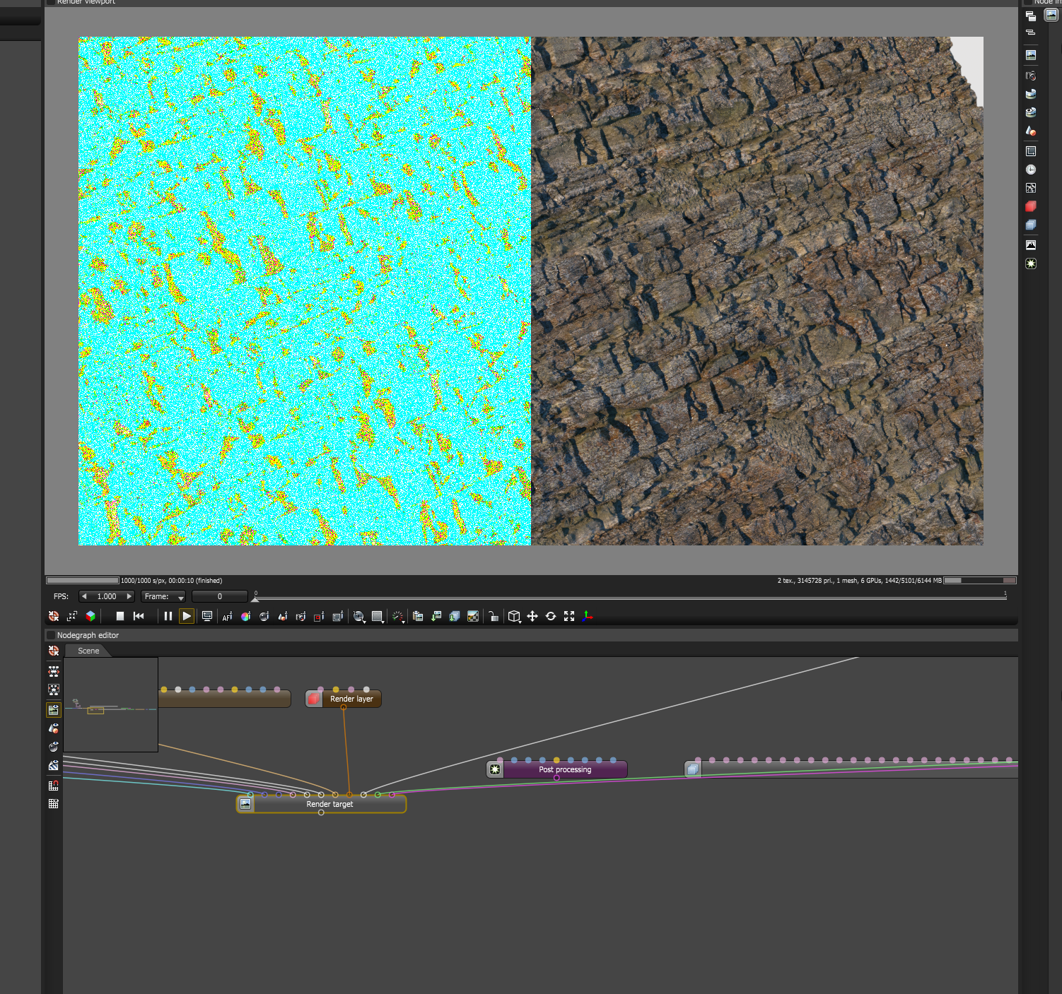

Nodes are giving wrong results, colors are completely off, when the scene starts rendering with local GPUs image looks fine but when Octane starts adding results from the nodes it all goes completely wrong in terms of colors. When I switch off the nodes image looks fine. Any idea why is this happening ?
Just tested 2019.1 RC3 and it is working fine in that regard.

BorisGoreta wrote:Nodes are giving wrong results, colors are completely off, when the scene starts rendering with local GPUs image looks fine but when Octane starts adding results from the nodes it all goes completely wrong in terms of colors. When I switch off the nodes image looks fine. Any idea why is this happening ?
Hmm, you have updated the nodes to the right Octane 2019.1 standalone version, right? Do you know if the same happens in Standalone while rendering one of your scenes, after exporting it from LightWave?
Could be great to know if this problem could be related to the denoiser or the upsampling, for example. Do you have this problem with any scene, even while rendering a simple one?
Thanks,
-Juanjo
Yes, it is broken in standalone too.
