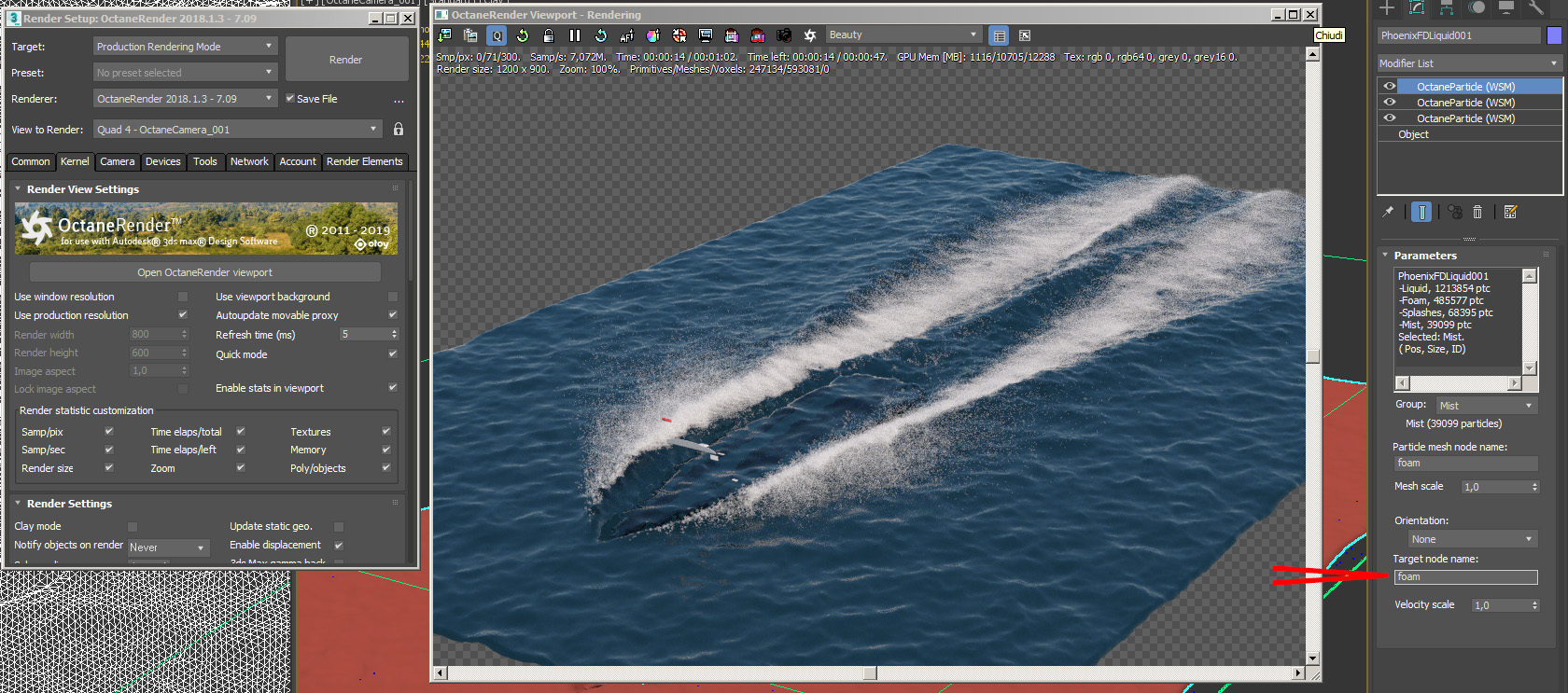

Hi remka,
After some test, I think I've found an issue and sent to developers.
A workaround is using Octane for 3dSMax 2018 - 7.09, put foam in Target node name, then open your file in 7.11

Hell Paride,
I've put "foam" in target node name" in 7.09 and I've rendered it on 7.11 but particles are still not updating in the animation (with SHIF+Q).
What's weird is that when I'm scrolling the timeline manualy with the Octane Viewport active, the particles are updating well

Hi remKa,
you would set your scene to movable proxy.
Regards

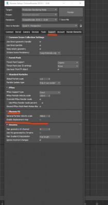

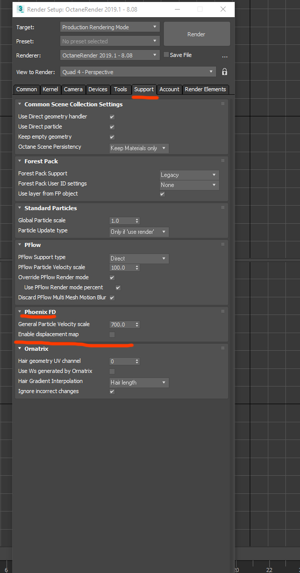

did you try to enable in octane support phoenix dialog?

Location: Paris
Yes, it was ON everytime I tried !
Did you manage to make it work ?

remKa wrote:Yes, it was ON everytime I tried !
No. We had this bug many years ago and that's why they added this checkbox. I didn't know it is not even working.
did you try to set Notify objects on render to ALL objects in render settings ?
