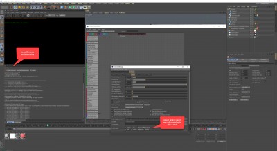

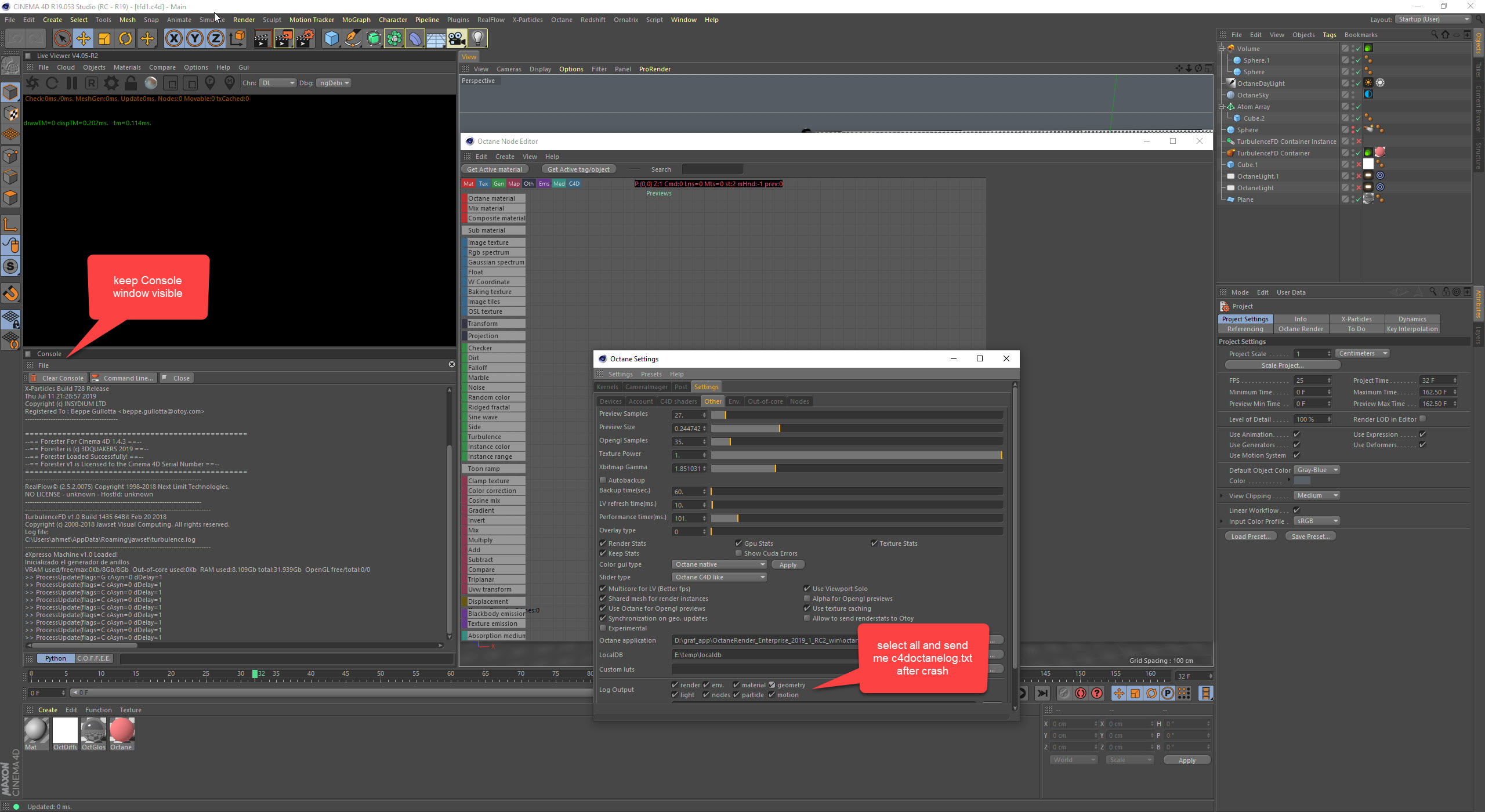

Could you show render log outputs(c4doctanelog.txt and bugreport.zip) and a screenshot from crash moment as in picture?

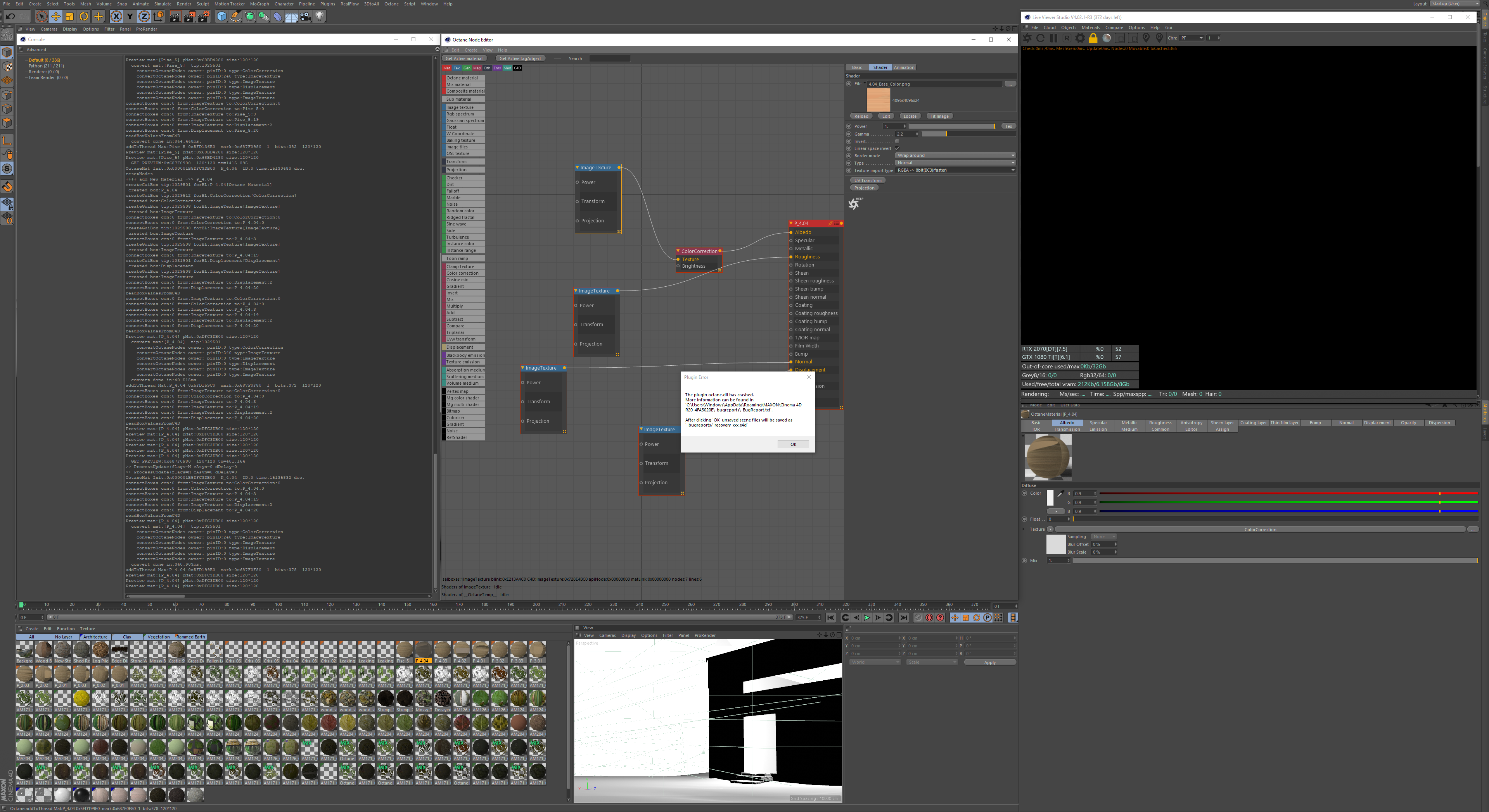

Thanks aoktar, here are the log and the screenshot :
