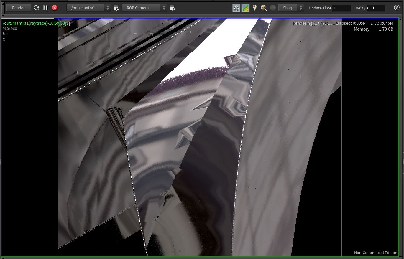

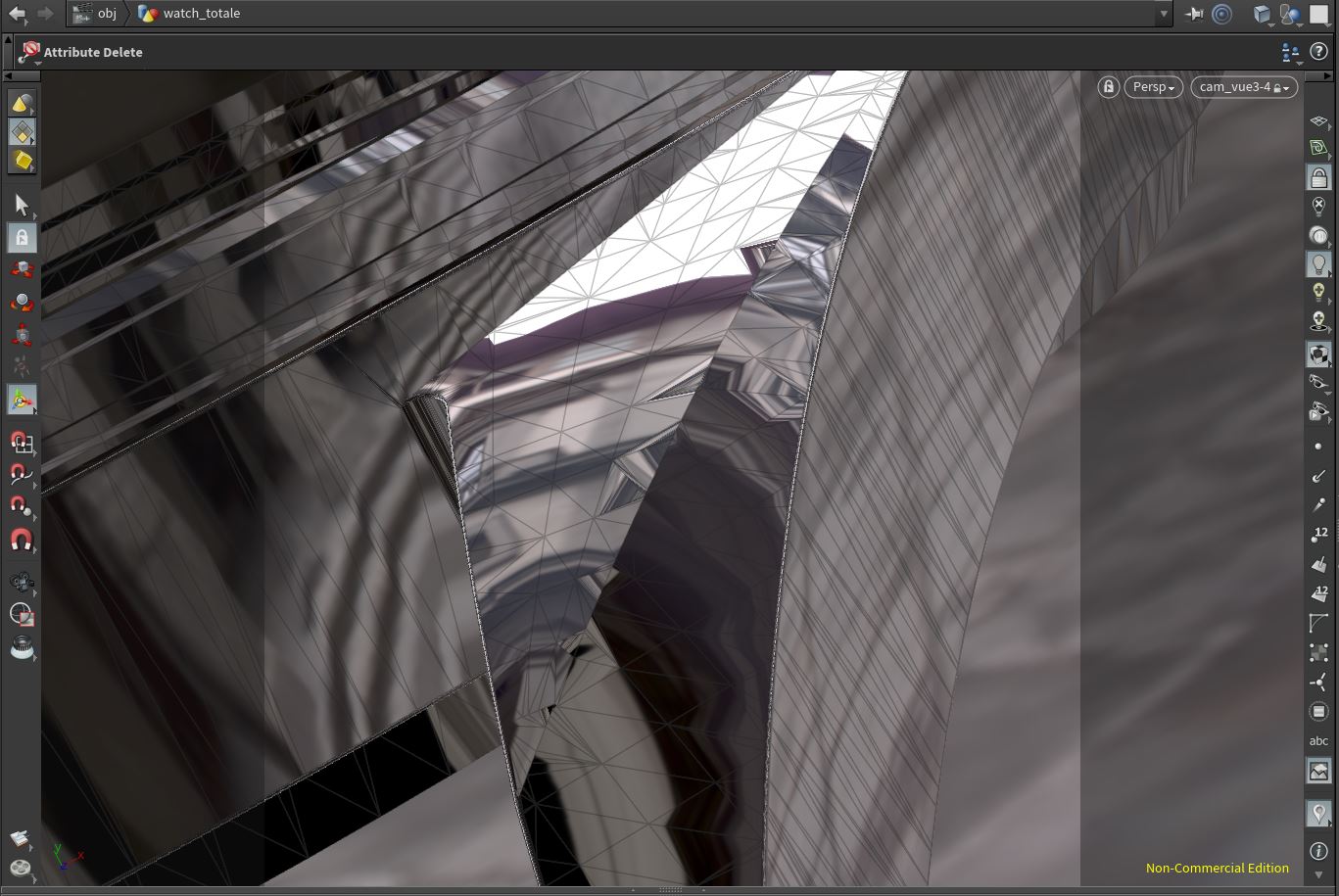

Sorry for the late reply, I'm in a short vacation break. I'm not sure why you get these artifacts in this object, but it seems related to the object itself because as you can see in the attached images, I get the same artifacts in the viewports or in Mantra. I tried to improve the mesh topology using the clean sop and so on, but without luck so far. I suspect that the problem can be related to the bunch of small and thin polygons available in the mesh, but I'm not sure ... perhaps you could ask SideFX about this issue.
