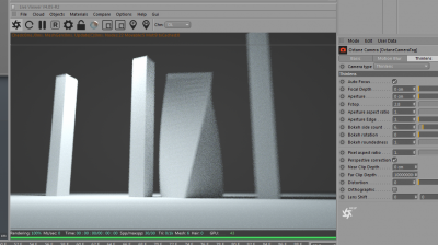

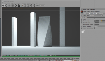

This issue is old, but CamMB+PerspCorr still doesn't work.
Currently tested on latest stable V4.05-R2

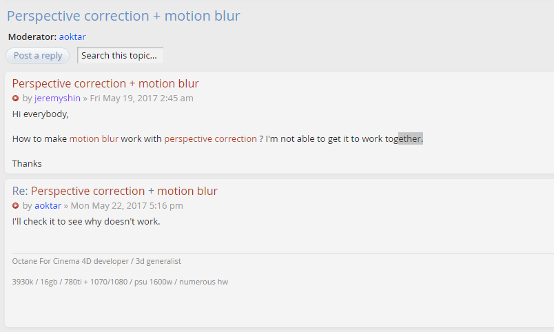

Why? I've found a topic 2 years old with words "I'll look", but nothing changed
Should I post it over Octane engine thread?

thank you for reply, but the trick does not effect on Camera MB + PerspCorr. I had just one result - or corrected perspective or Camera MB, not both unfortunately
