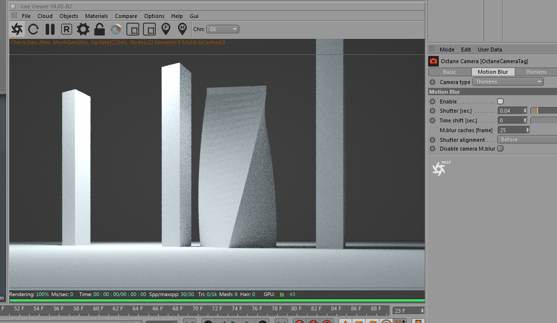

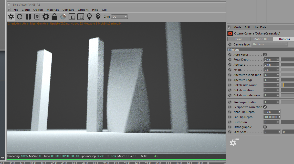

This issue is old, but CamMB+PerspCorr still doesn't work.
Currently tested on latest stable V4.05-R2
Why? I've found a topic 2 years old with words "I'll look", but nothing changed
Should I post it over Octane engine thread?
Camera Motion Blur + Perspective Correction = doesn't work

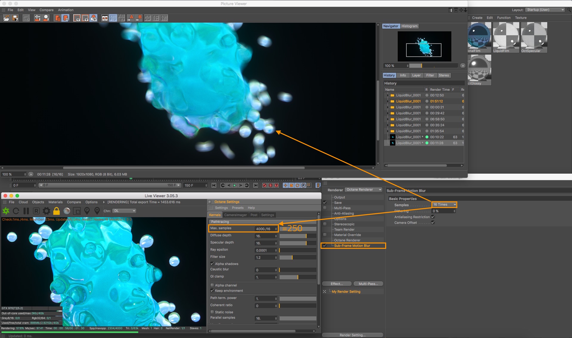

try with the sub-frame trick: ciao Beppe
thank you for reply, but the trick does not effect on Camera MB + PerspCorr. I had just one result - or corrected perspective or Camera MB, not both unfortunatelybepeg4d wrote:Hi,

Alternatively, you could set the pitch rotation to 0, and use the Lens Shift option, instead of the Perspective correction.

I know and use time to time option you mentioned.
It works well on a dolly shots or simple cam animation
