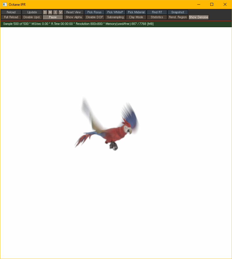

This is 1 bird, as a crowd Agent, so its a packed prim, by itself it renders perfectly fine using deform-mblur in octane settings
single bird agent - octane

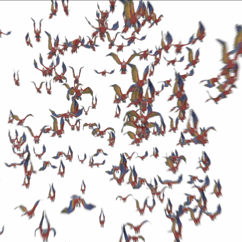

This all turns to shit once it has gone through the crowd solver etc, even with the added v above. I am also exposing the v in the obj parameters at sop level
Octane with motion blur on full crowd

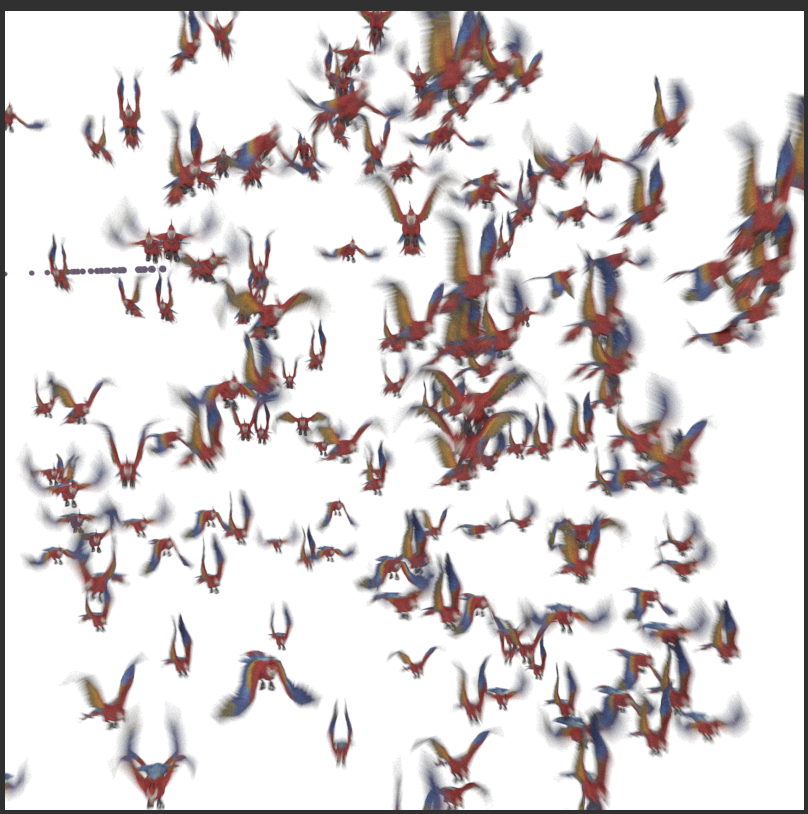

Comparison Vray for Houdini reads the velocity better, which can be seen on the wing tips etc. (it has its own issues, but not related to motion blur).
Vray with motion blur on full crowd

EDIT: So I sort of fixed this simply by unpacking them... it actually works quite well, but of course it would damn handy if we could get packed primitives mblur support too?

Probably the problem is that the packed agents' velocity attribute is overridden by the velocity attribute of the points and not added. I'll check it, but in any case, unpacking the packed agents is fine for Octane because I'm afraid that this is what the plugin is doing internally at the scene extraction time. The instancing of the packed agents is not supported currently.
