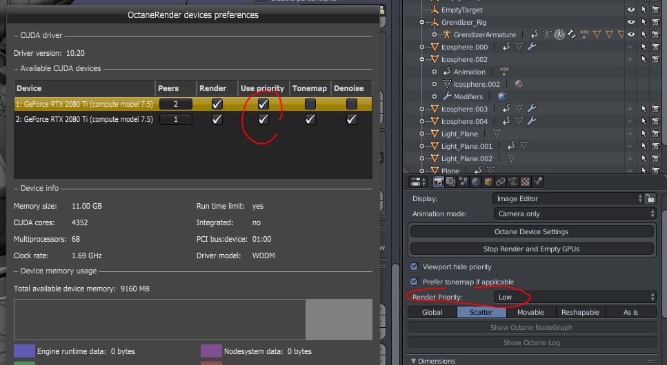

Preview Render should be fast. Can you show a snapshot of your settings? Those are mine:
If you have 4 GPUs, you may consider to disable the one used by the system in the Octane Device settings to maximize UI updates (you can totally disable any priority option in that case).

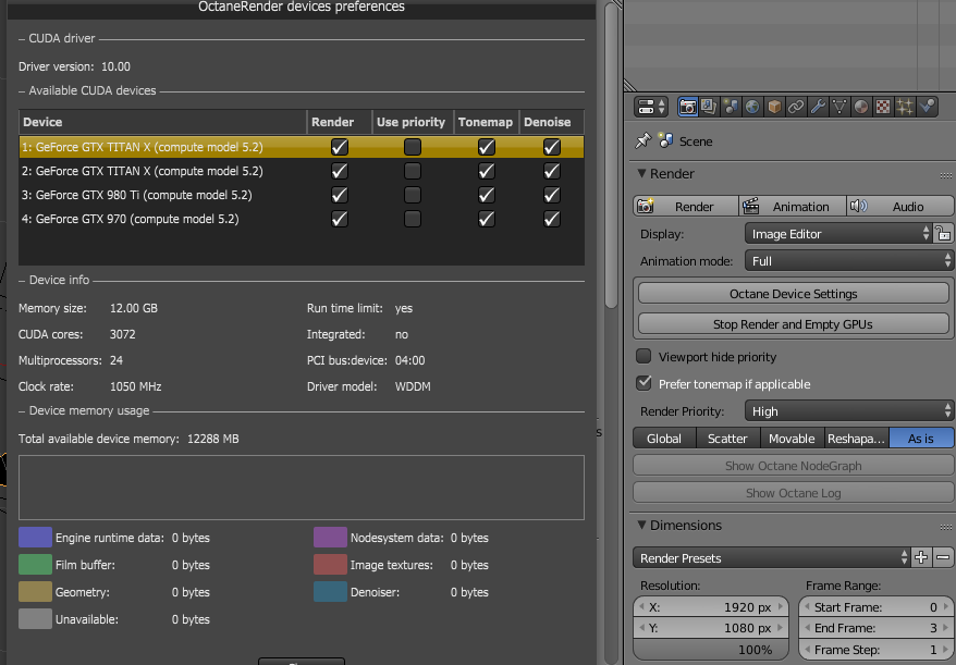

Here are my settings, but not shown, I have ticked Use Priority previously.
I like your idea of disabling one of the GPUs. I will try that with the weakest card, and hopefully it will cover browsing, etc.
Turn on priority for the main system card, at least.
Just be sure to find out which one is the system card (normally the one installed in the first slot of your motherboard).
