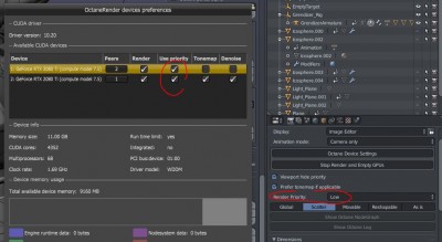

Preview Render should be fast. Can you show a snapshot of your settings? Those are mine: If you have 4 GPUs, you may consider to disable the one used by the system in the Octane Device settings to maximize UI updates (you can totally disable any priority option in that case).

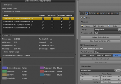

Thank you, Lino.
Interesting about the CUDA setting within Blender. Should I revert back to CPU within Blender Preferences, or no difference?
Here are my settings, but not shown, I have ticked Use Priority previously. I like your idea of disabling one of the GPUs. I will try that with the weakest card, and hopefully it will cover browsing, etc.
Off to Nvidia for the update, thanks.
Just curious: How are you liking your RTX cards? What did you use prior?
Best,
Rick
Best,
Rick

You're welcome!protovu wrote:Thank you, Lino.
That's making difference when using Cycles only. You can leave it to CUDA, no issues for Octane.Interesting about the CUDA setting within Blender. Should I revert back to CPU within Blender Preferences, or no difference?
Turn on priority for the main system card, at least.Here are my settings, but not shown, I have ticked Use Priority previously.
Just be sure to find out which one is the system card (normally the one installed in the first slot of your motherboard).I like your idea of disabling one of the GPUs. I will try that with the weakest card, and hopefully it will cover browsing, etc.
Good!Off to Nvidia for the update, thanks.
