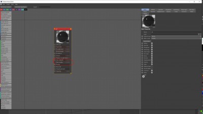

When I want to create a pearlescent material but I can not find "film width" and "film index".
Here is what looks like:

you have selected the Sheen tab, that is a completely different characteristic than Film Layer, please have a look at the manual here:
http://www.aoktar.com/octane/OCTANE%20H ... lated.html
If you double click on material, and use the separated Material Editor window, it is not complete.
Please, edit your materials in Attribute Editor, or in Node Editor:
ciao Beppe

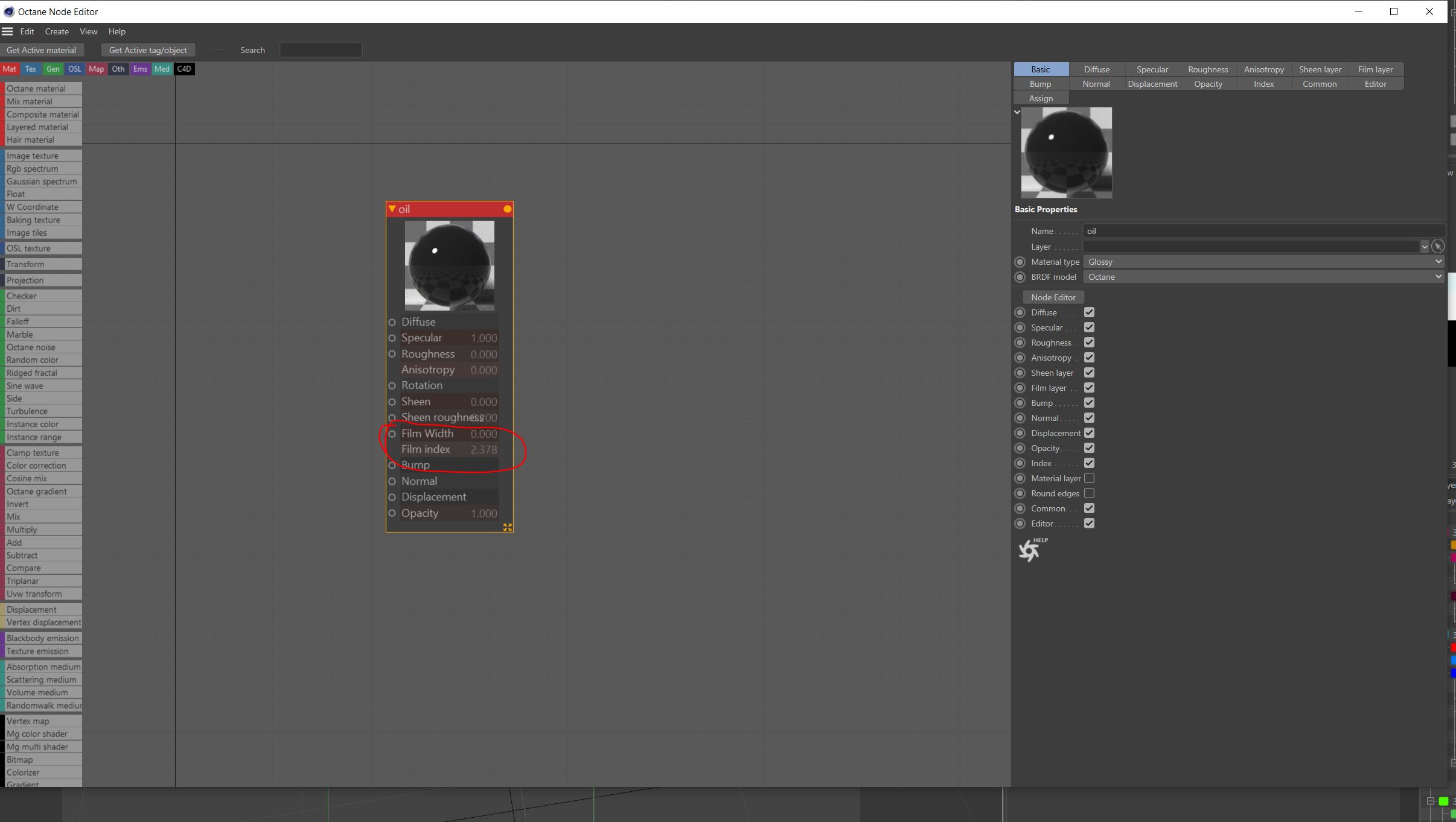

He's saying film index and film width are not present in the material/node editors.
I'm actually here because I'm having the exact same issue. See the screenshot below.
Posts: 10643
Sorry but I don’t get why you think it is wrong :roll:
Those on the left are the names of the channels of the material, not the list of all the available parameters.
Each channel could have several parameters.
Just select the Film Layer to see the specific parameters of that channel.
ciao Beppe

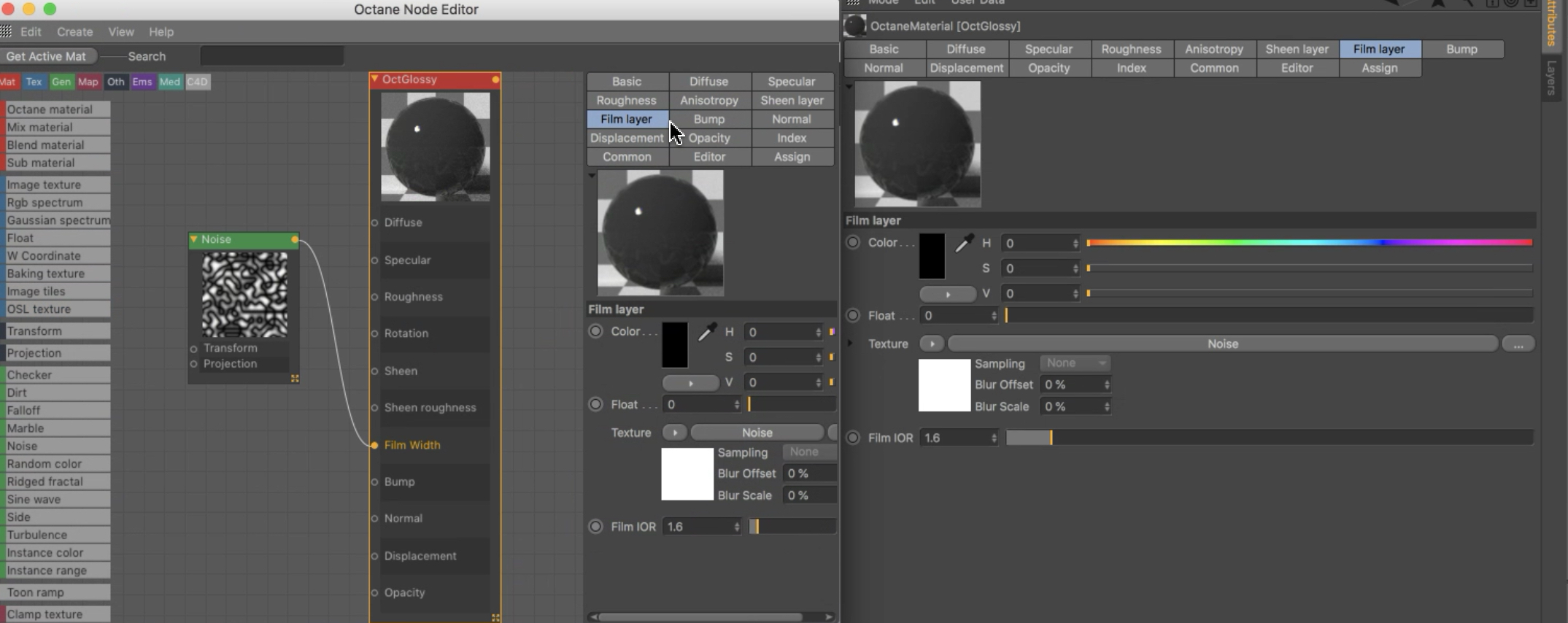

hey guys,
open the material in the node editor.
there you have the film index and width.
or in the film layer tab:
float = film width
film IOR = film index
