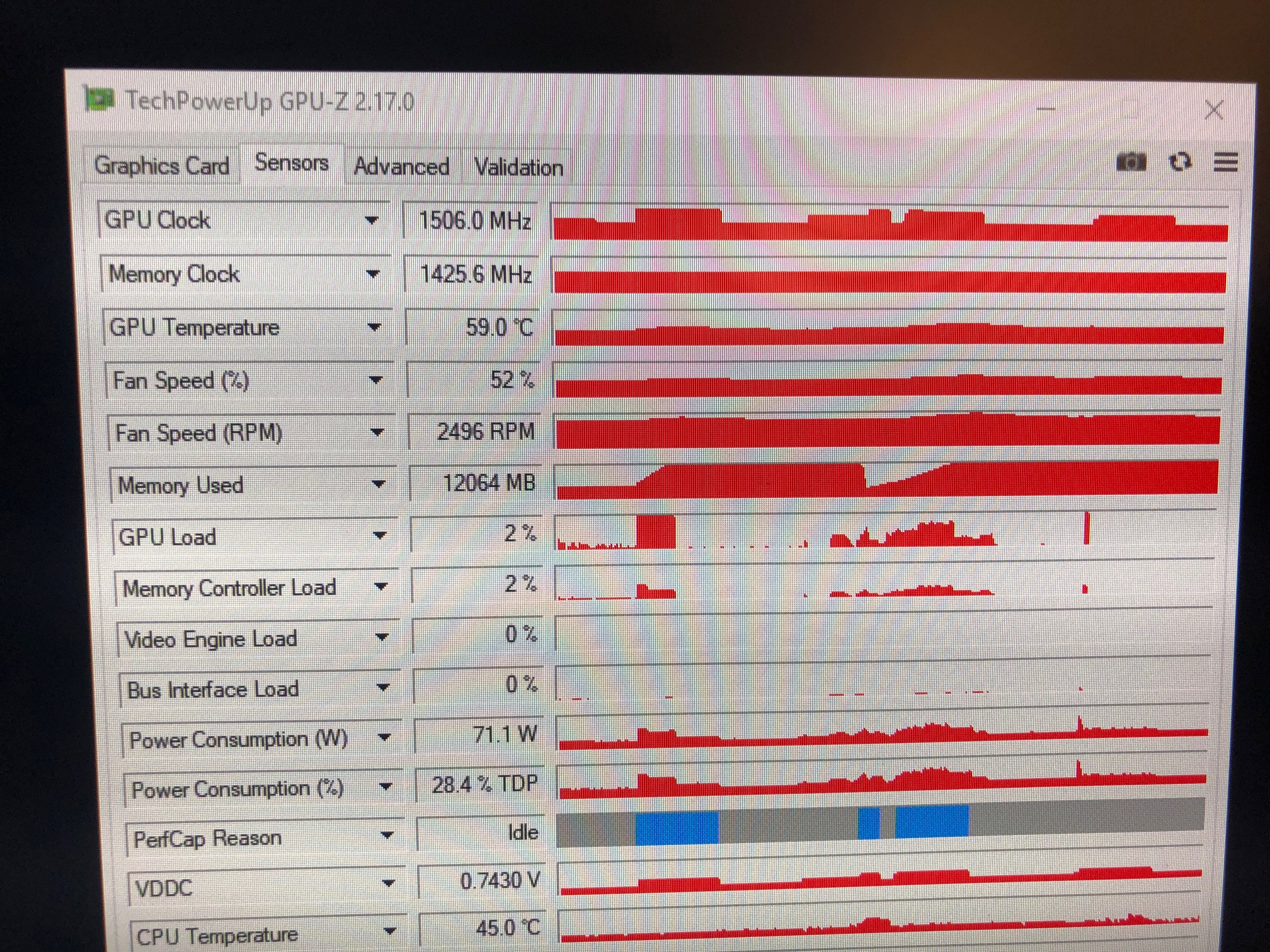

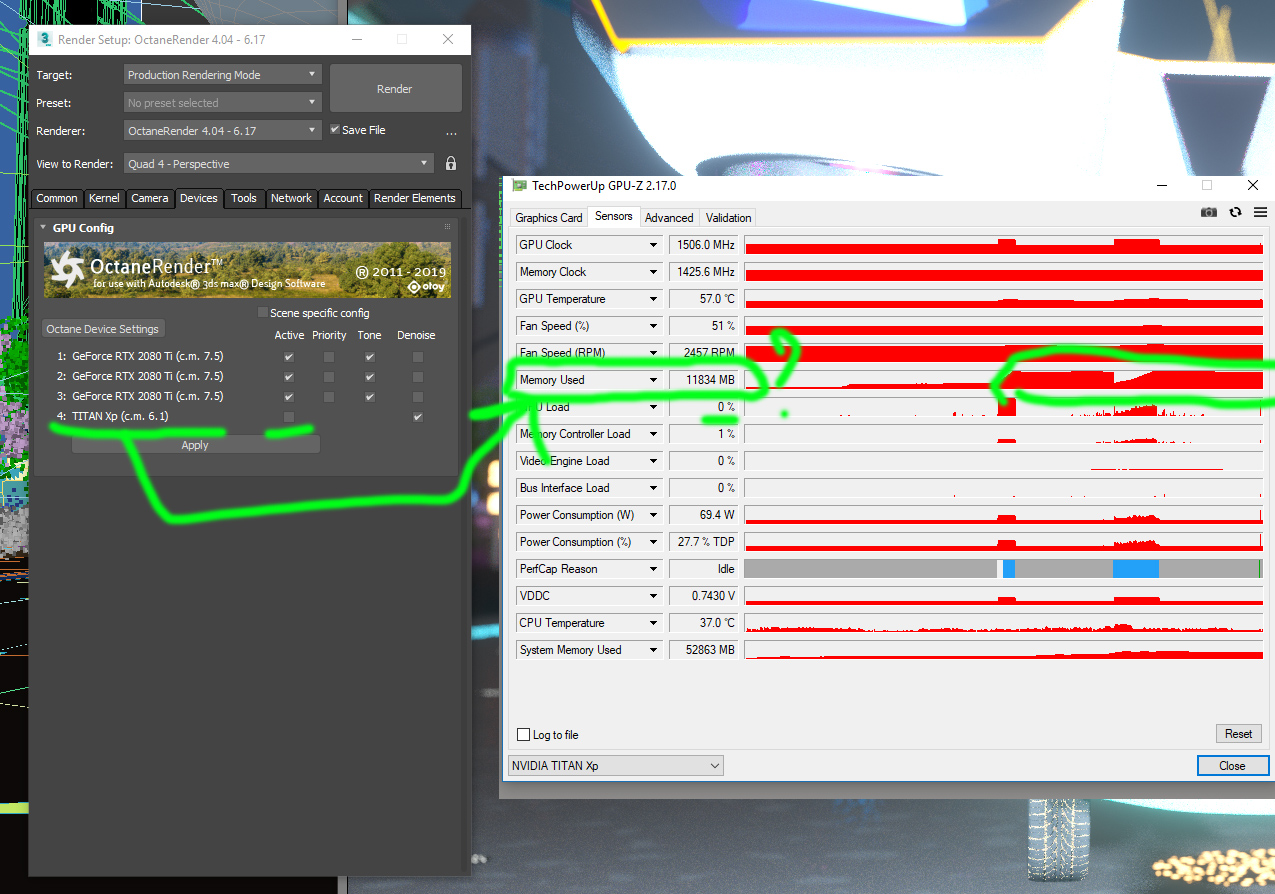

Hi Paride,
So after a reboot when I start rendering my vram usage on display card goes from 1 Gb to full usage of all 12 gb. This titan xp is only used for display and it is totally inactive in octane even for denoising. It usually happens with very large scenes that use around 8-9gb of 2080ti vram.
I am not sure why octane uses all vram of a display card because when I stop rendering vram drops back to 1 gb. GPU load is only 2% so octane uses vram for some reason.
I think it is a bug or something

Hi coilbook,
3dsMax file uses Titan XP VRam, so it's quite logical your very large scenes fill all Titan xp VRam.
it seems strange to me Titan Xp Vram empties when you interrupt the render.
Are you sure?
Regards
