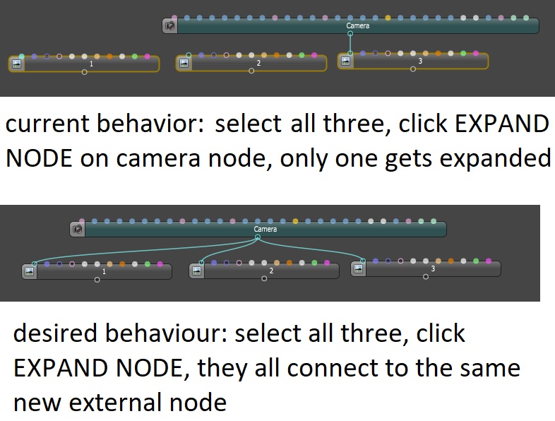

This is more of a general Octane problem, but I have not found a fast way to create a node for multiple elements easily without plugin them all manually. when I select multiple nodes and selct one of their internal nodes and click EXPAND, it would be great if all those nodes could connect to a new node instead of just one of them connecting to a new external node.
The node is not actually "new" it holds the same data as the internal node. Your suggestion has the problem that 2 of the nodes will be overwritten and have their information changed.
Would you know of an easy way to connect 20+ items to a new node? The node workflow gets less powerful the more nodes I have to connect manually.
