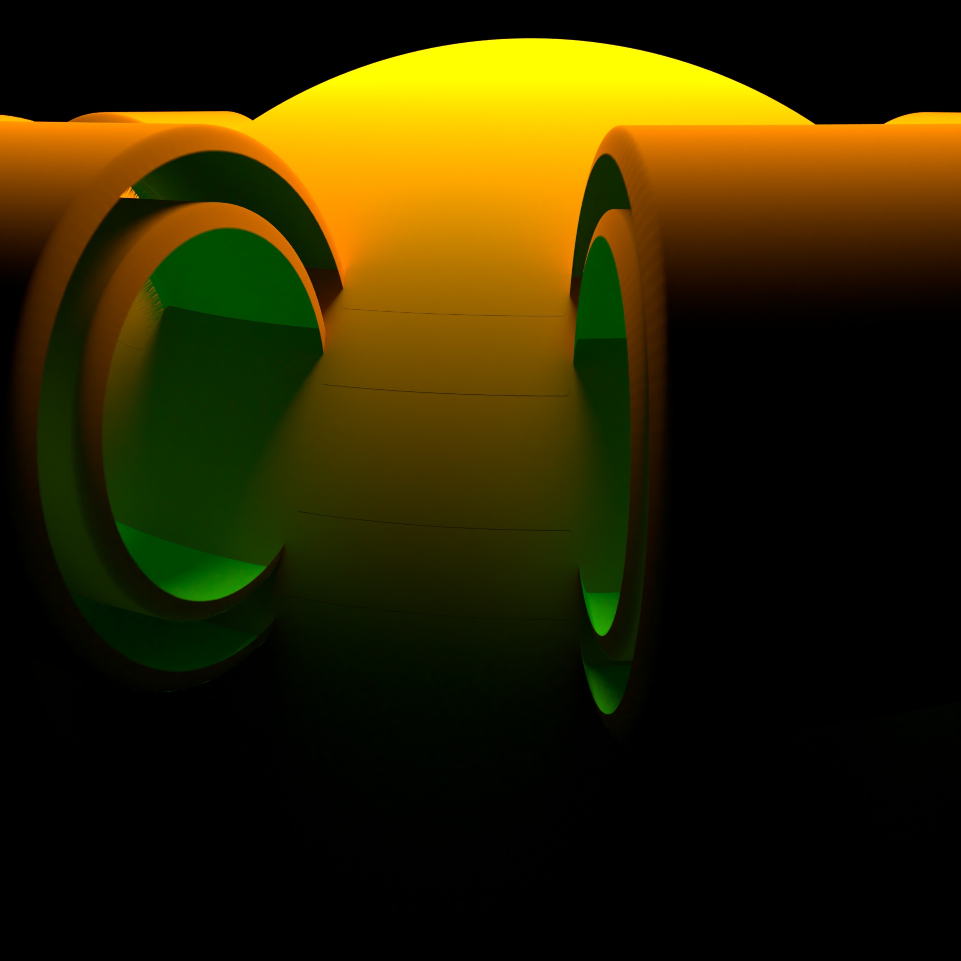

But now i see that there is a line of pixels at the gap where the texture loop is closing - and i can not get rid of it.
I exported the scene to Octane Render 2018.1.2 - sadly i saw it there too.
See my pics attached, you can see the line of pixels that normallly should not be there at the gaps - the sphere primitiv got it too..

Pixel on bounds that should not be there - part 1
Here you can see 2 issues: The mysterious Pixels that occur on boundries / edges when objects meet. And a loading failure...
In this test example the pixel failure show up without displacement - shaders taken from Live DB.

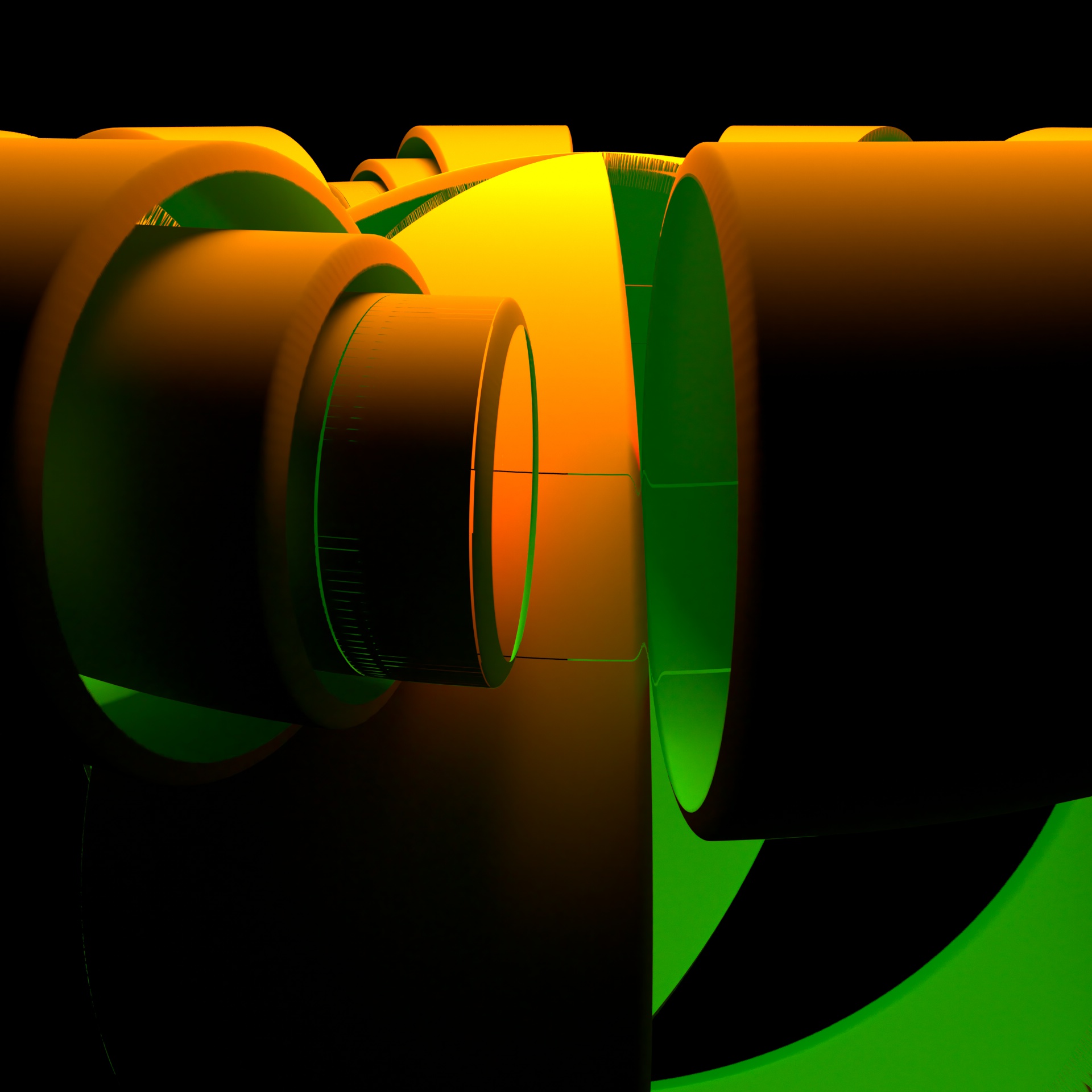

Macro - the slice becoming visible on invisible borders from the alpha shader object - without displacement the pixel failure does not show up in this example.

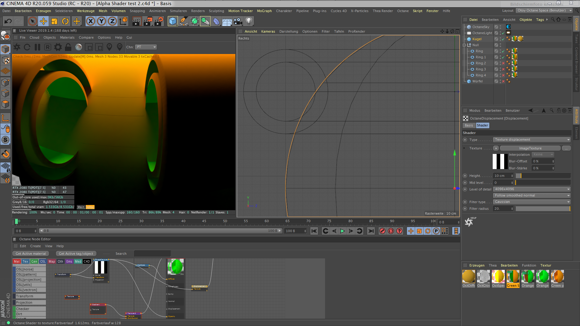

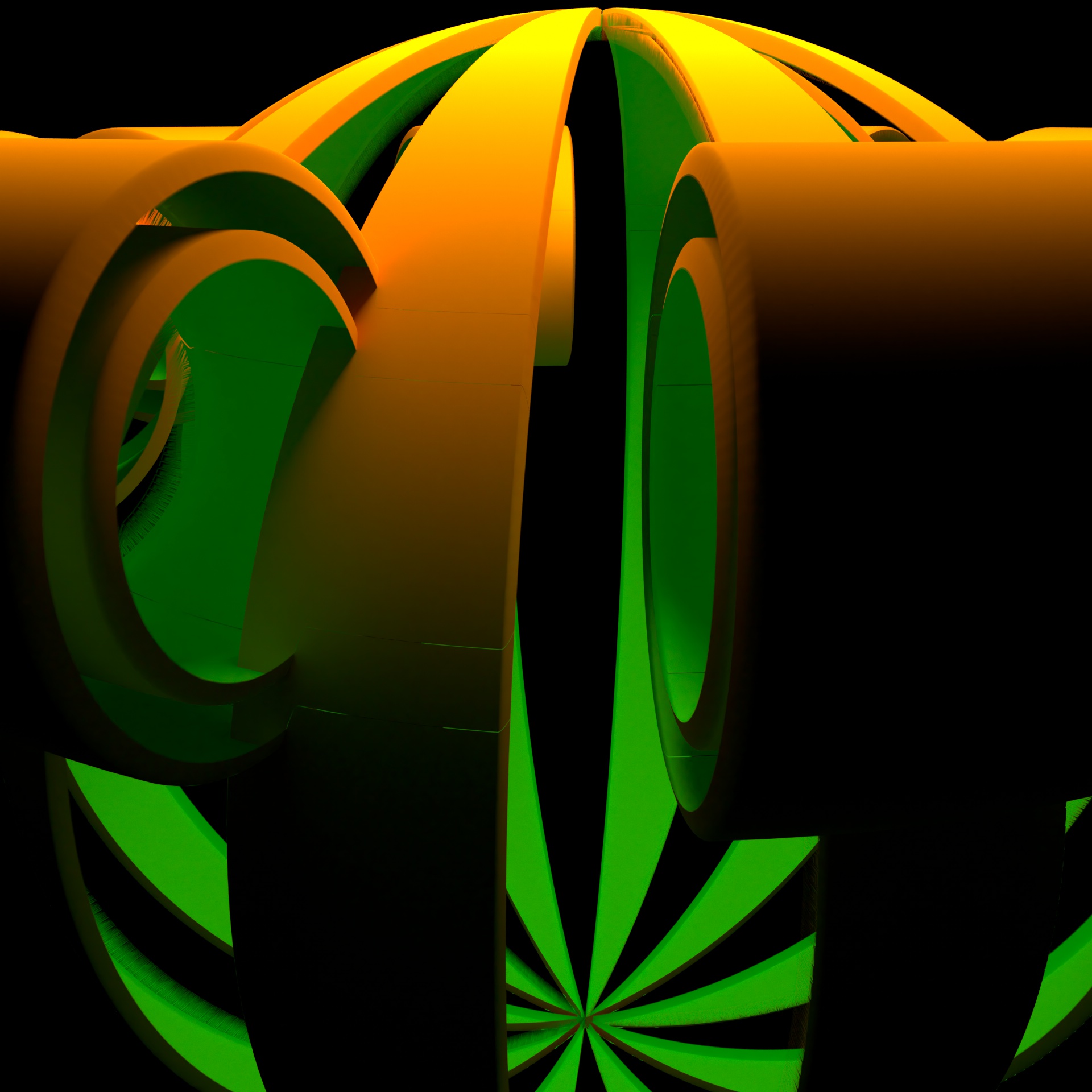

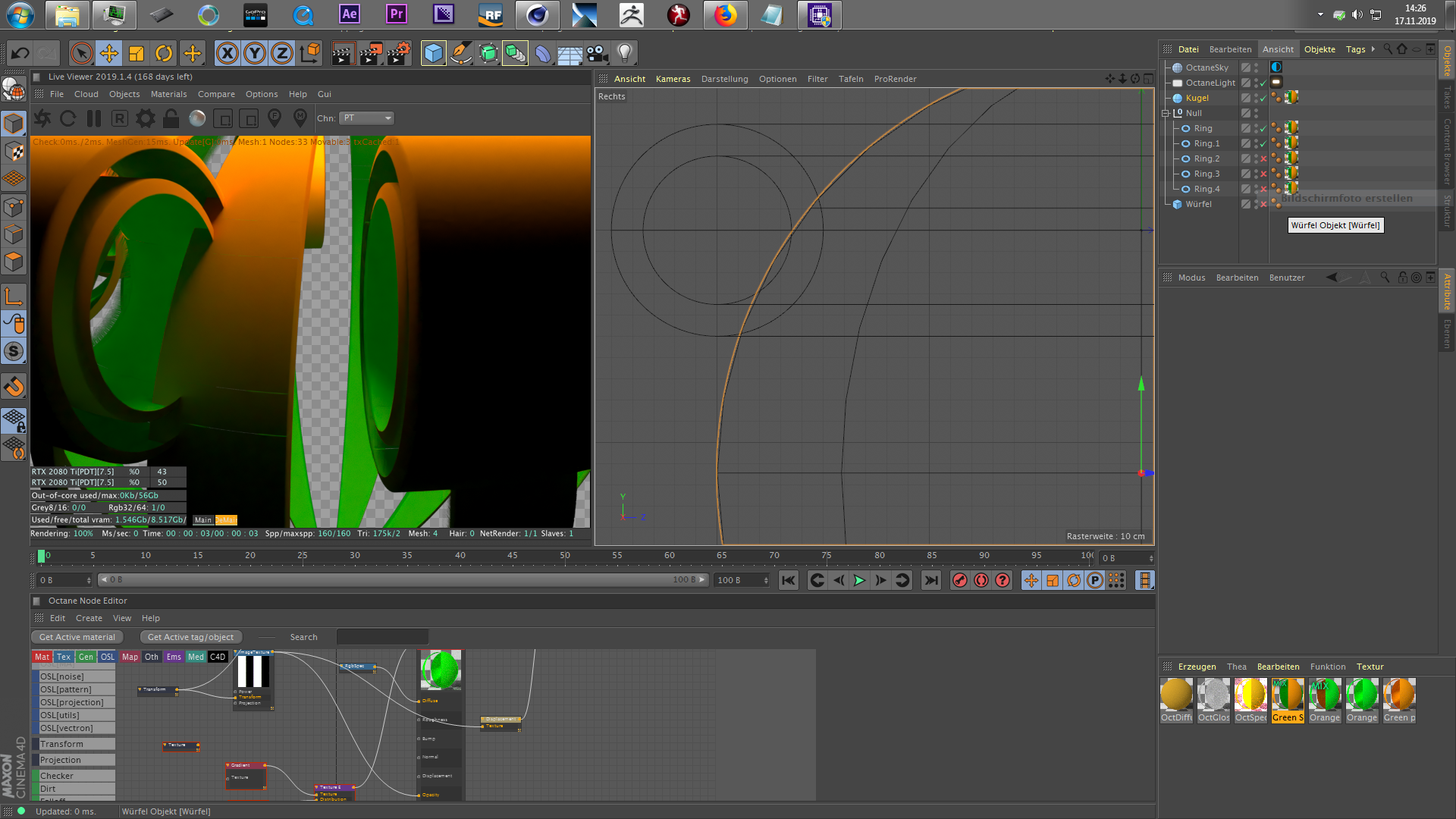

Unwanted Pixel part 2 - Here are another strange behaviour with displacement and touching objects.
The Alpha is generated from a File in the opacity channel of the shader.
