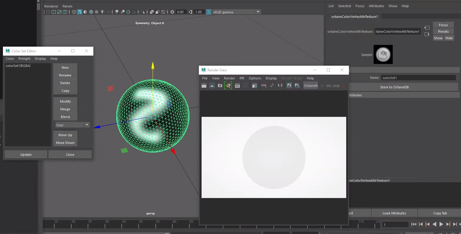

How to make work the node with the color vertex node??? here a screenshot of my screen, I add the name and doesn't work at all. Did I made something wrong?

Jolbertoquini wrote: How to make work the node with the color vertex node?

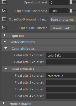

You just need to fill out the name of the colorset in the new "vertex attributes" section.
- Adding the colorset name in a "Color attribute" fileds will extract RGB color.
- Adding the colorset name in the "float attribute" fields will extract by default the alpha component of a maya RGBA colorset,
or you can be specifically add ".r", ".g", ".b" or ".a" at the end of the colorset name.

Thanks Pascal! Little hide extra data I thought to put the name just on the node would be enough like for upsets but never mind thanks to point out this.
