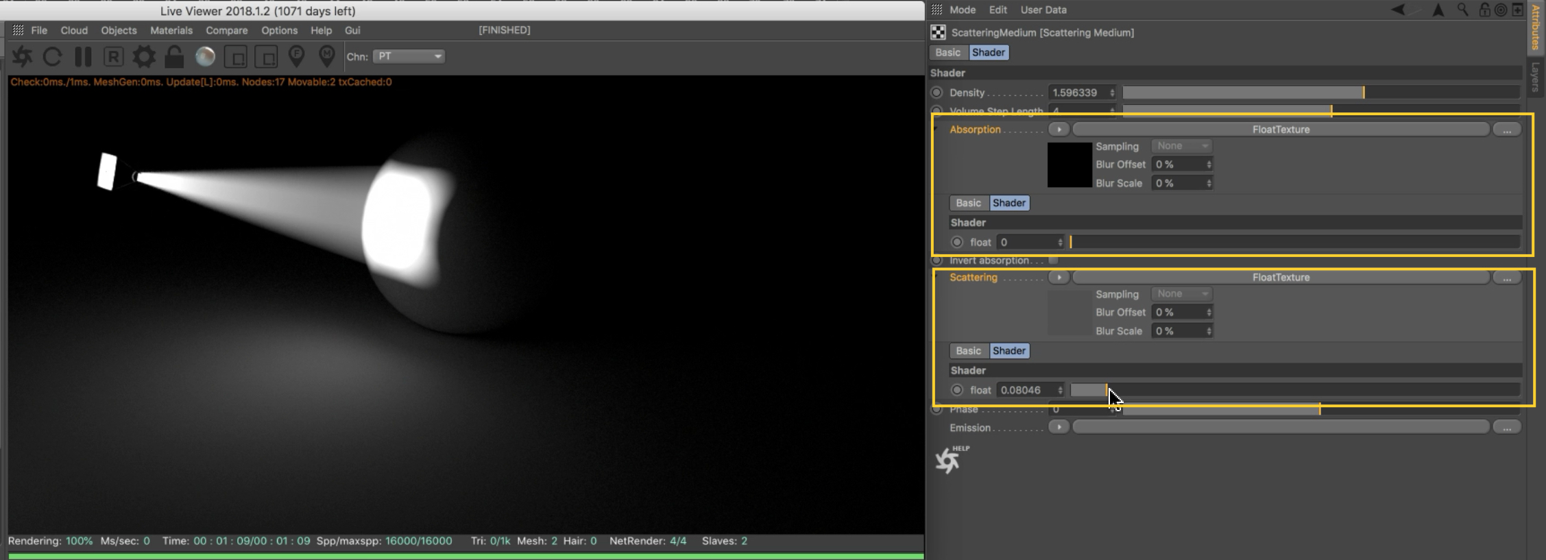

Posts: 10563
in the Scattering Medium of the Spectron light, set the Absorption at 0 Black, and low gray values for Scattering parameter:
ciao Beppe

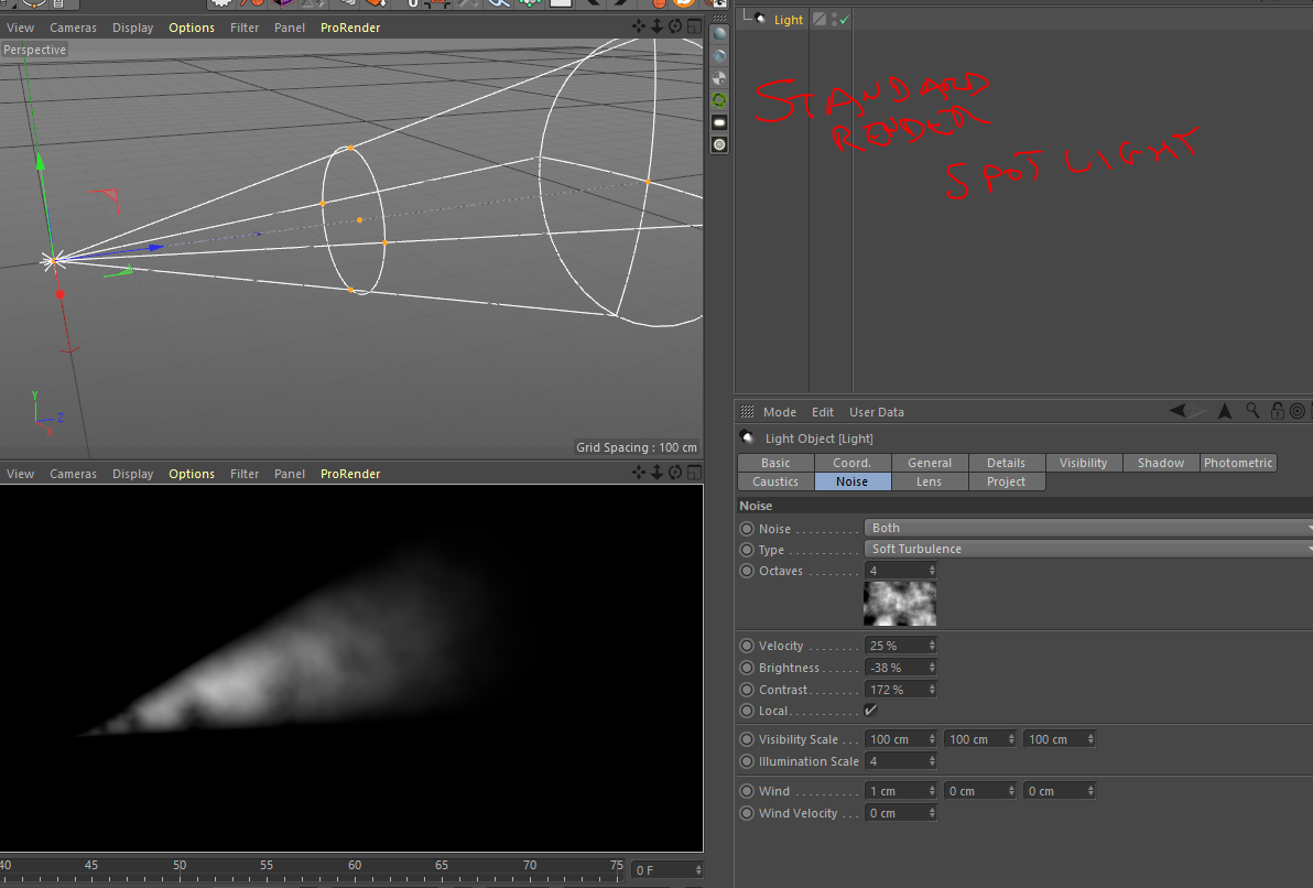

Im having to render a pass in C4D standard render to get spotlights in my scene.
Also I was hoping to have some noise in the spotlight beam like you can with the standard render ones.
Posts: 10563
try to reduce a lot also the Scattering value, it seems still at 0.5.
About noise, currently is not possible in this setup.
