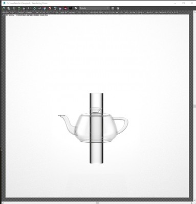

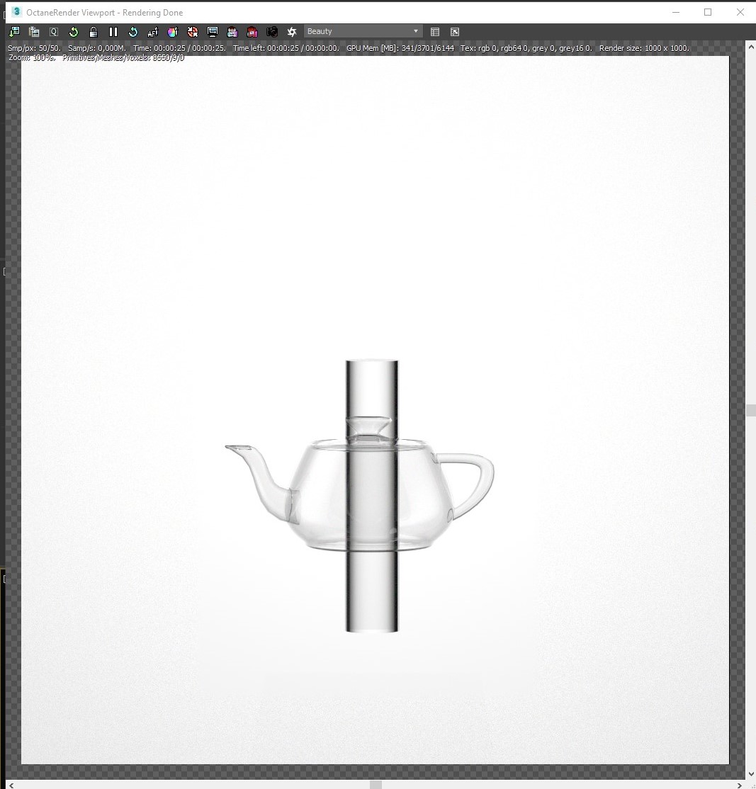

Whats wrong with reflections/refractions in the png? they do not correspond the original jpg preview

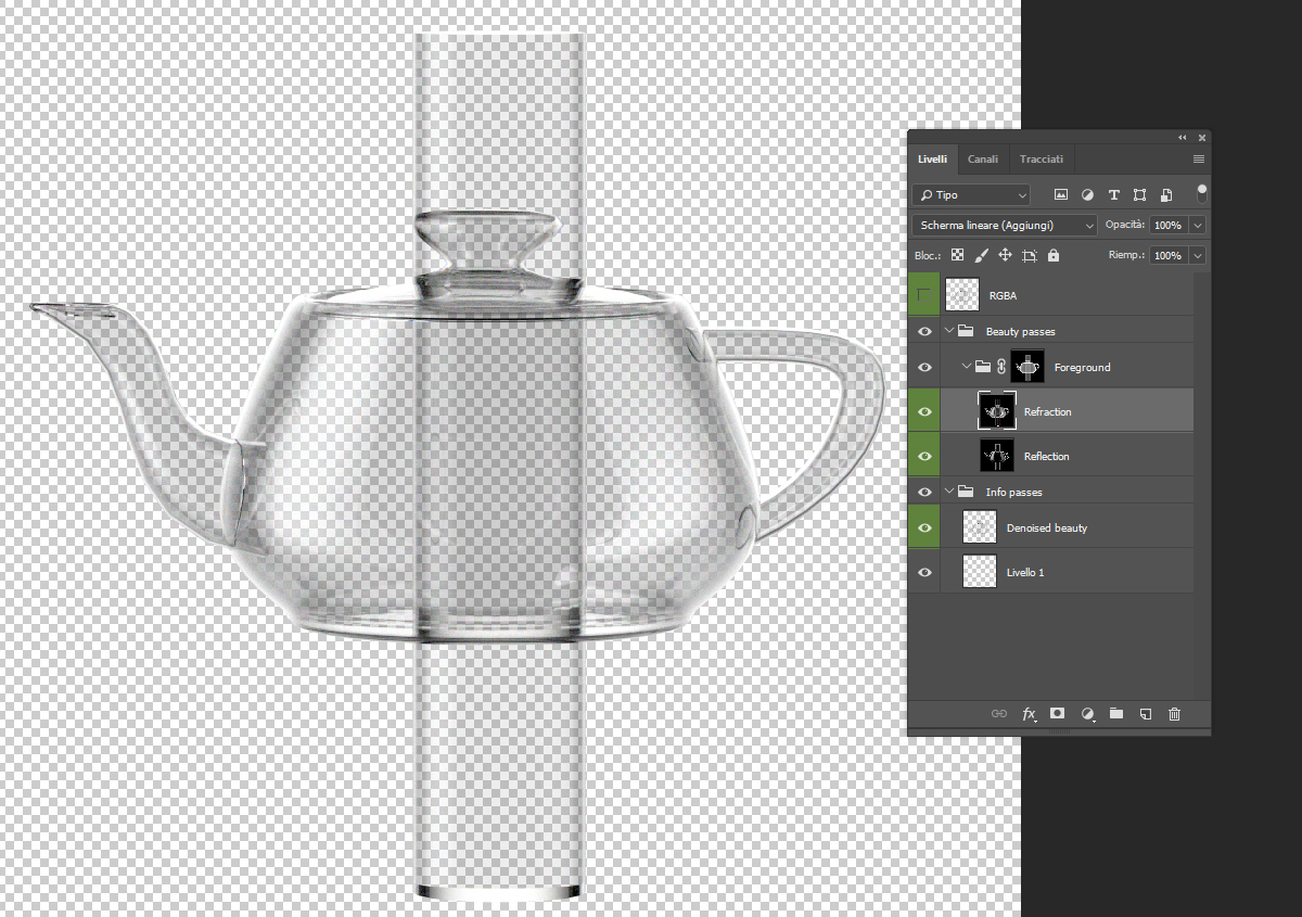

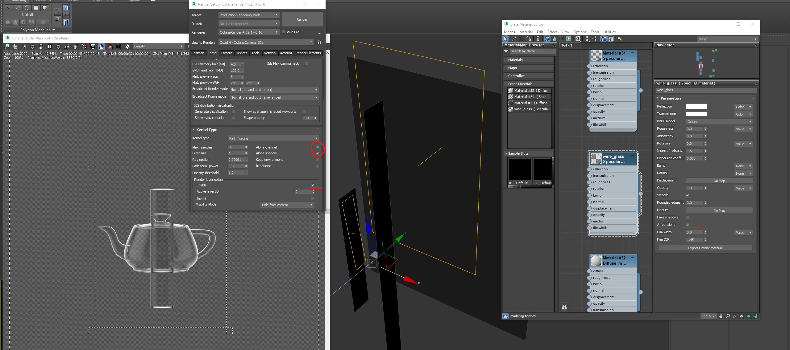

Hi Scrudje,
I think you forgot to select Reflection pass.
you should assign Active layer ID as you want and select render pass.
Eventually you could check Keep environment option in Kernel panel, saving image with alpha.
Regards
Paride

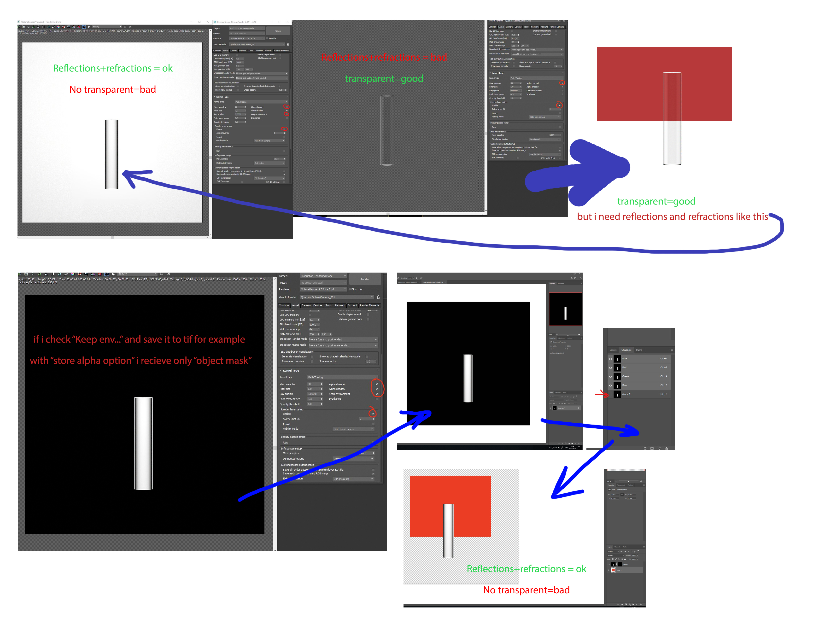

1. Doesn't matter reflection and refraction passes doesn't have this "black" strips like on original preview when alpha channel+render layer is onparide4331 wrote:Hi Scrudje,
Regards
Paride
2. If i check keep environment i ..... just look at the attach file.

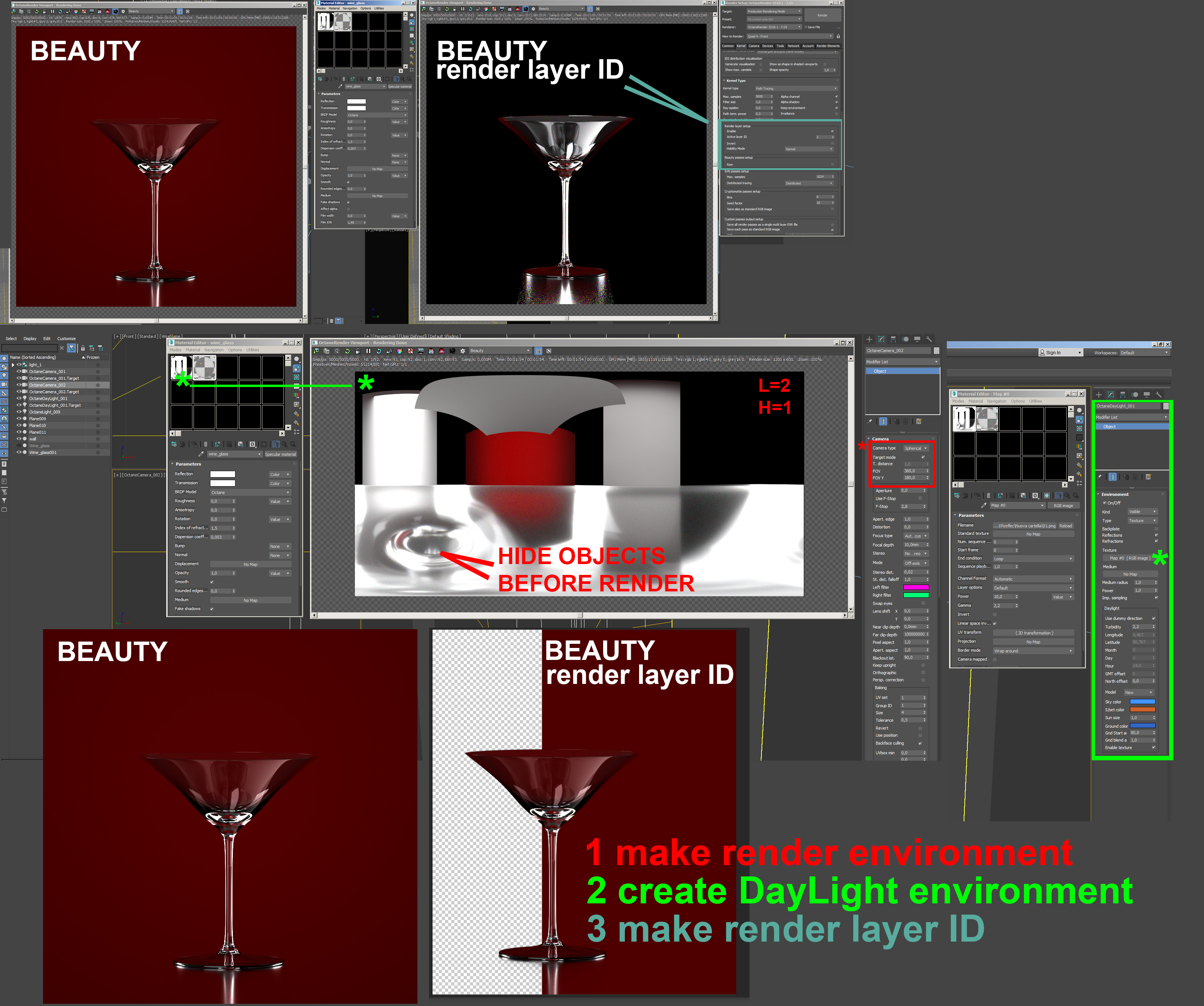

Hi Scrudje,
maybe I don't understand the question, maybe you're not considering that you are working with linear compositing. therefore black equals 0.
viewtopic.php?f=27&t=66757&p=336128&hil ... op#p336128
Regards
Paride

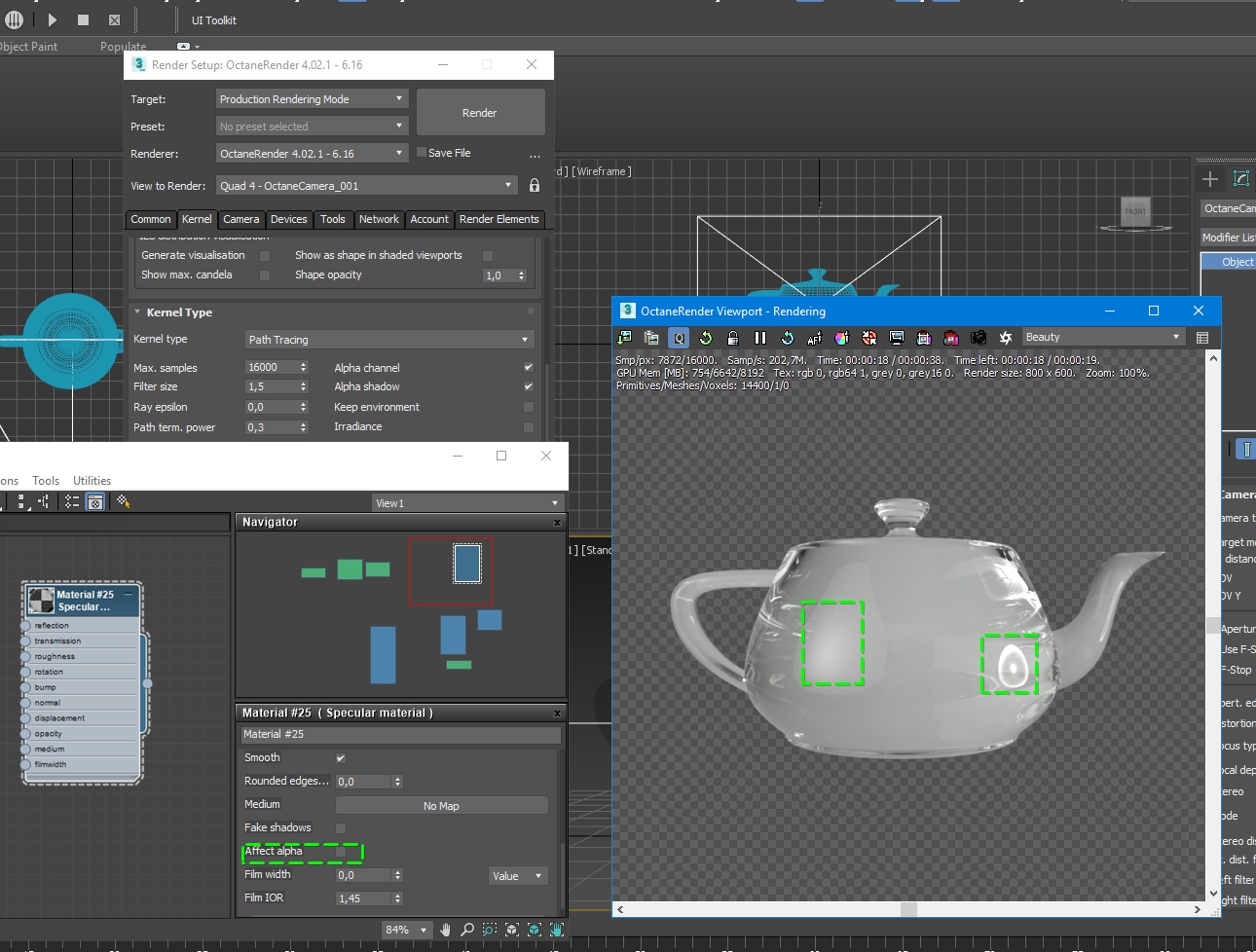

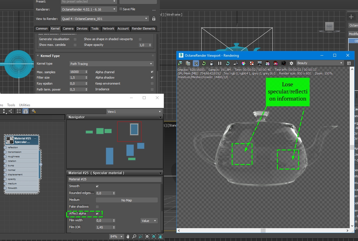

Paride, forget about passes. I think the problem is, that with Affect Alpha ON we lose some specular-reflection information. Check my images.paride4331 wrote:Hi Scrudje,

You absolutely right, this is the problem about i post.ramone163 wrote:paride4331 wrote:

Does not matter how i make final image: render 1 beauty pass or render compositing passes like diffuse/reflect/refract etc. Final image must be with alpha which is included all reflections and refractions from beauty pass. In my example alpha does not have all this details(black strips from cylinder), alpha just make this black strips transparent, but it should not be.
If i open exr/tif/psd etc. in soft like photoshop i can blend passes/make alpha masks and change to any background, but i need PNG with plausible alpha without any blends.
I hope well explained
