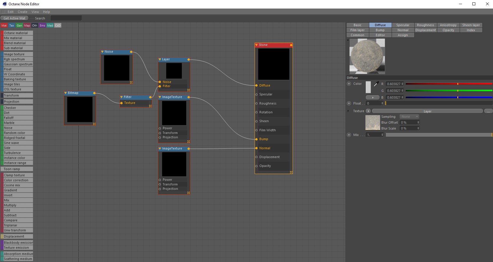

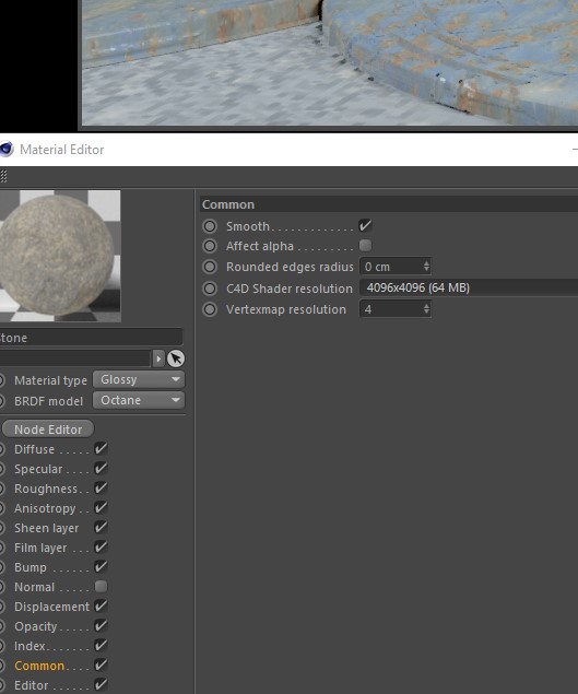

how to increase the resolution of a texture. As you can see in the live viewer the resolution is very low. I´ve changed the C4D resolution to 4096 but nothing changes.
Where is the hidden regulator?

That screenshot doesn't really provide enough info to offer a suggestion. If you share a shot of the whole node network in the Octane Node Editor, you'll probably get an answer.

What do you do exactly? It will use the resolution of images without tweaking anything.

I do nothing special. It`s a shader of a octane shader collection.

This is the worst possible use of octane things. I mean that using c4d shaders, like layer/filter/etc.. It forces the plugin to bake them to bitmaps at first level of c4d shader and loose time and quality for conversion.
Posts: 10598
Please select the Layer node and share a screenshot.
It could be surely replaced by one or more Octane nodes, without need to auto-bake it, loosing speed and flexibility.

Here the full Layer node.

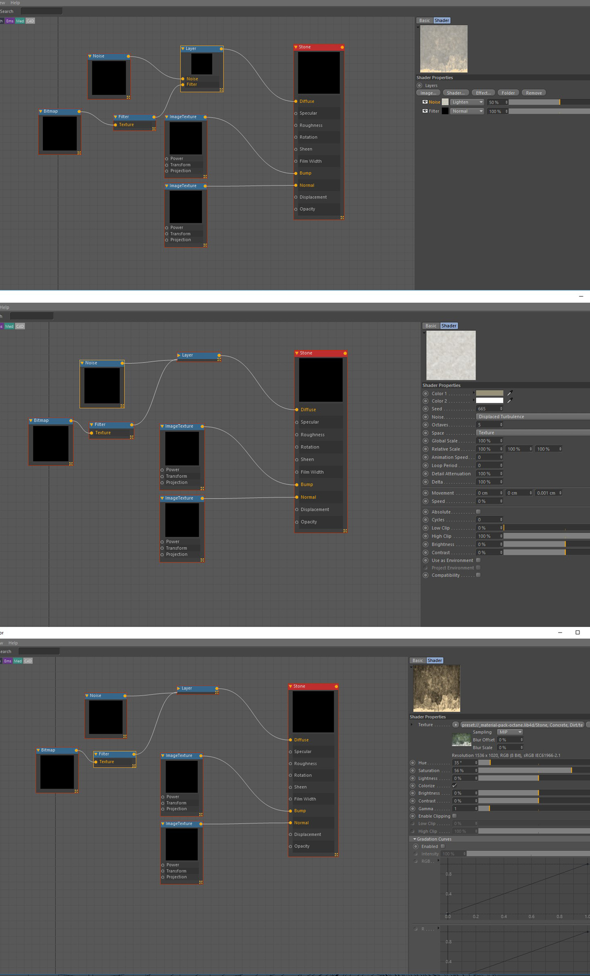

a possibile solution is to use an Octane Noise into a Gradient node to have the same behavior of the c4d noise, then use a Color Correction node to adjust the gradient noise, and use an Add node to mix the noise with the texture.
