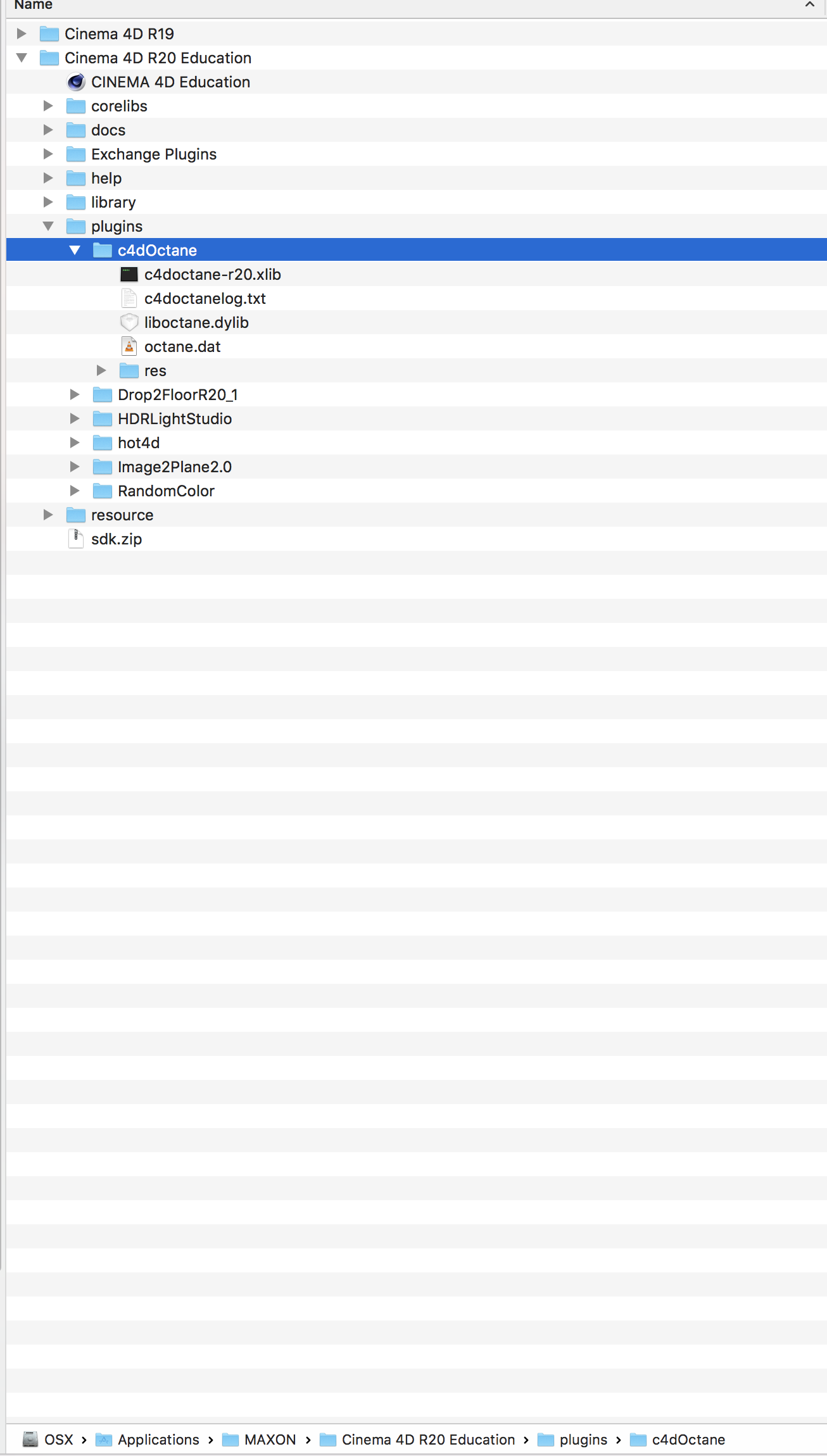

Please, share a screenshot of the R20 c4doctane directory with path, thanks.
ciao Beppe
If plugin works in R19, but it doesn’t in R20, probably it is not correctly installed.
ciao Beppe

Hi
please, remove the installed version, and try to install in the following directory:
HD\Users_Your Name_\Library\Preferences\MAXON\Cinema 4D R20_random code\plugins\
Please have a look at this installation video for C4D R20:
https://youtu.be/nPjloJ3X7x4
ciao Beppe
ciao Beppe
