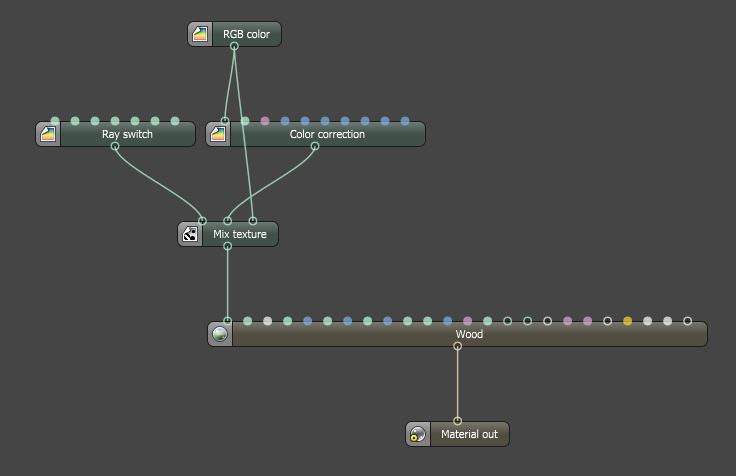

Hesekiel2517
Posts: 467
Joined: Mon Nov 23, 2015 10:57 pm
I just was looking for a way to reduce color bleeding, because I always had to deal with wooden floors which lead to colourful walls. Best way I found is to use a rayswitch node with diffuse set to 0 and using that for a mask to reduce the saturation of the material diffuse color.
