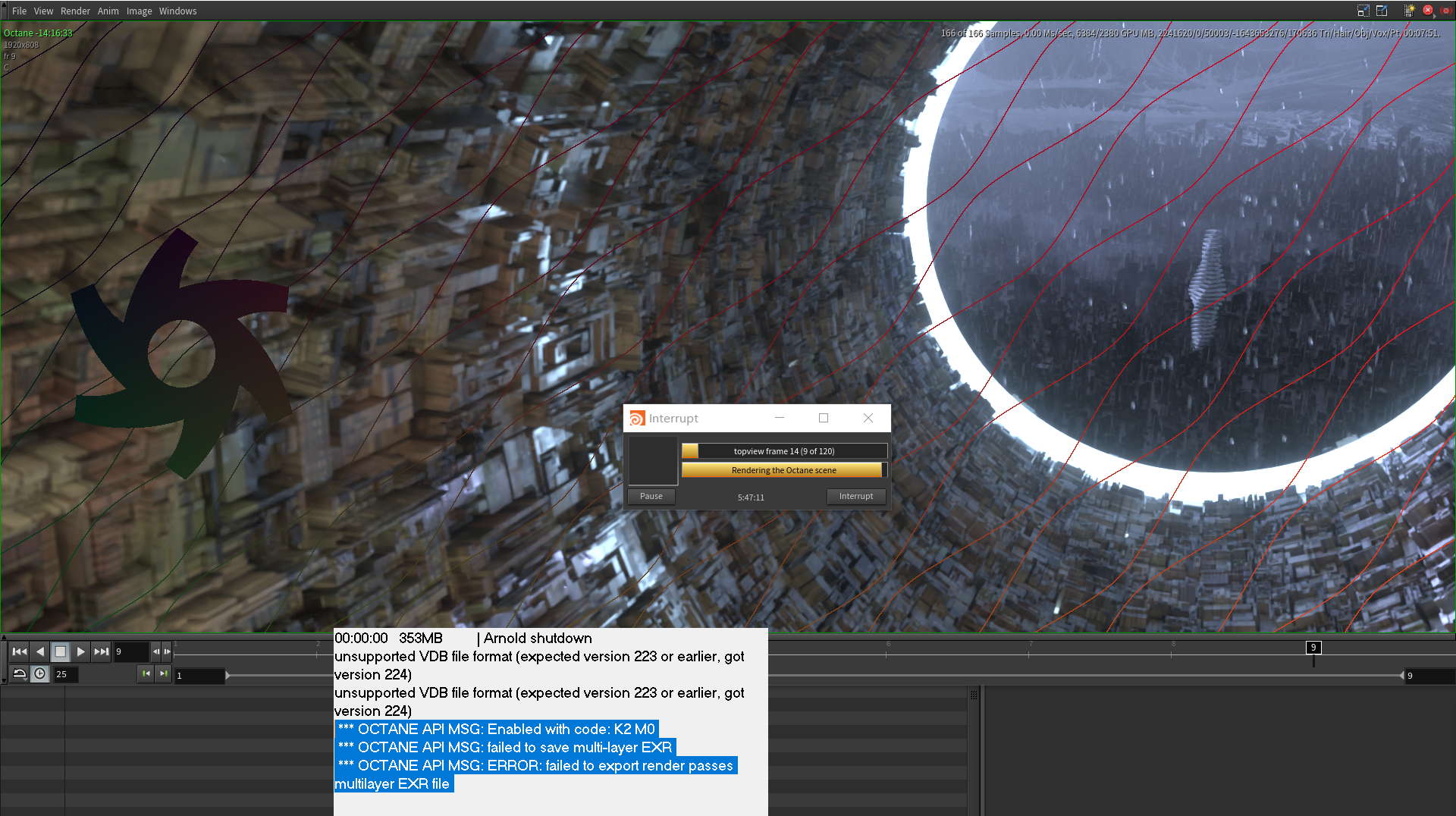

Hello,
There is a error when rendering picture, and has watermark on it.
version:
houdini 17.0.416
Octane for Houdini 2018.1.0.7
rendering be interrupted

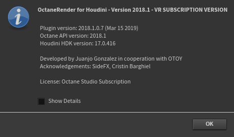

Frame1-8 doesn't have any watermark, only frame 9.juanjgon wrote:Hi,
Hmm, but it seems that you have the demo version installed, or somehow the plugin is loading the demo Octane core libs. Can you please double check your plugin installation again to be sure that you don't have a demo version installed at any place in your system?
Thanks,
-Juanjo

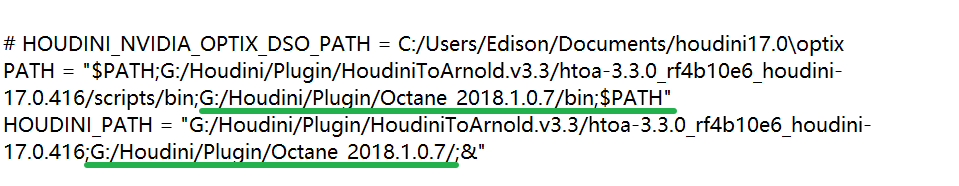

That's my plugin information.
I just install one plugin version for Houdini.

Oh,unfortunately, that always is exist....It seem that stop at 99.9%juanjgon wrote:Hmm, perhaps there was a problem with the license servers, the internet connection or something like that. To be honest, I had never seen a commercial plugin build rendering with watermarks.
