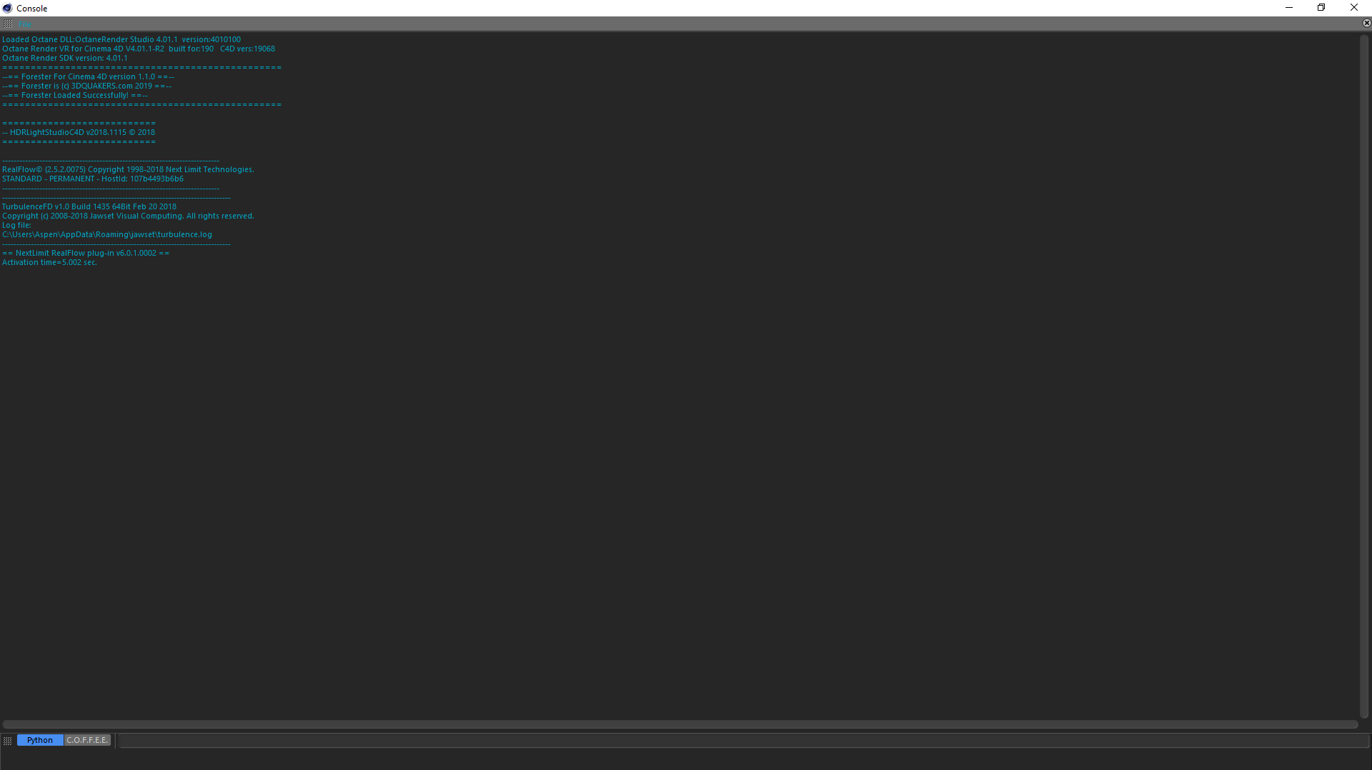

Here is a screenshot of my console window with the working version of octane (4.01.1) since C4D won't start with the newer one.

Here is a screenshot of my console on the version of octane that works (I can't get to the console on 4.02.1 since C4D doesn't even start properly)
