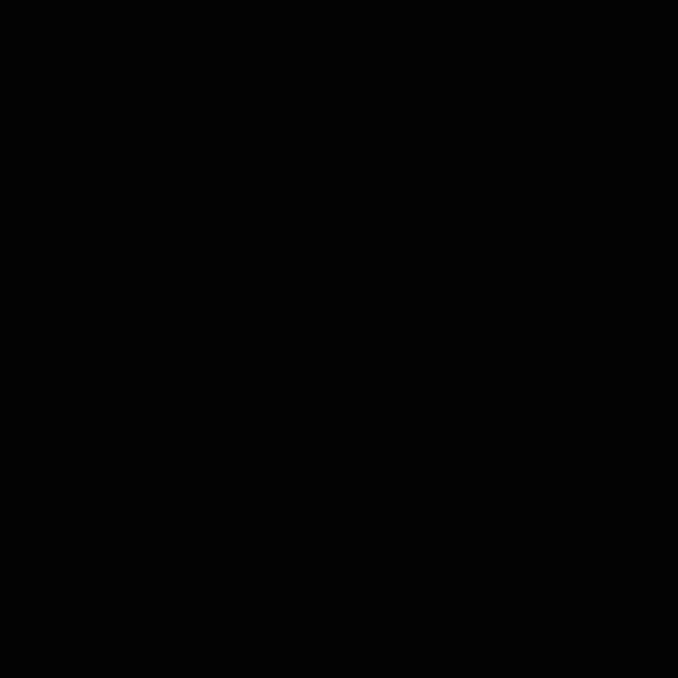

I'm trying to render a scene using XParticles with an Octane VR Camera in Stereo and it doesn't work, there is some weird things happening (see render below).
I've tried many render settings, with and without caching the particles and I'm stuck...
Does anyone have an idea ?

There's not any different for stereo or normal rendering for particles and caching. It's still one frame. I think it's a different issue.

Yes, it's a different issue because i've tried with a classic camera and I have the same problems...
It's a really simple scene with particles emitting from an object and follow its surface with trails...
I have tried to rebuild my scene from scratch in a new project but it doesn't work...
I don't understand what i'm doing wrong :cry:

OK it seems to come from the "render as hair" in the octane object tag because i've tried using a spline mesher and the render is working (see render below)
But it inscrease drastically the render time per frame...
Any idea why the "render as hair" do that ?
