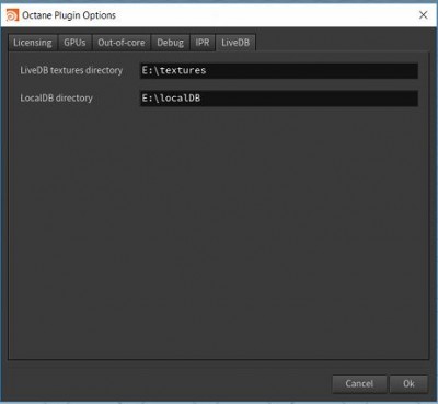

The problem can be related for example to the LiveDB textures path, that you must configure in the plugin options panel, as you can see in the attached image. A not valid path could be the source of some problems with the LiveDB feature.

I set up the source for the localdb in both the Octane program and plugin, it still crashes everytime I press import. It does that to any material in any scene I create.

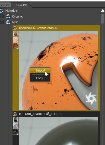

Hmm, so do you say that Houdini crash just after trying to import a LiveDB material using the "import" option as you can see in the attached image? Sorry, but here this feature seems to work fine. What plugin version are you using?

sorry for late response, but I am using the newest versions for both Octane and octane plugin for houdini fx 17.0.352, and yes everytime I press the import button just like you have it in the screenshot, my program just closes.
