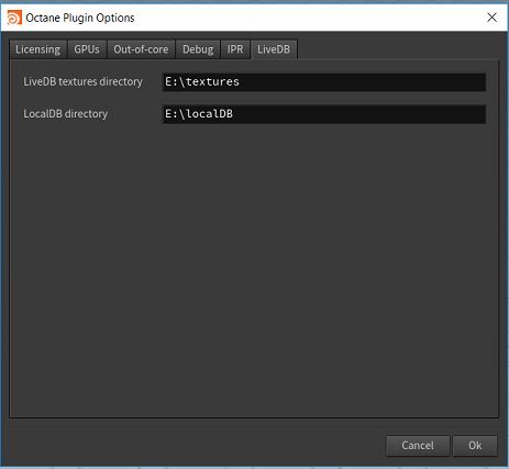

Sorry, it is Monday here, so I've just seen this post after the weekend. Here the LiveDB feature seems to work fine. What Octane plugin version are you using? If possible try the latest one released 2018.1.0.7
The problem can be related for example to the LiveDB textures path, that you must configure in the plugin options panel, as you can see in the attached image. A not valid path could be the source of some problems with the LiveDB feature.
thanks,
-Juanjo
I set up the source for the localdb in both the Octane program and plugin, it still crashes everytime I press import. It does that to any material in any scene I create.
