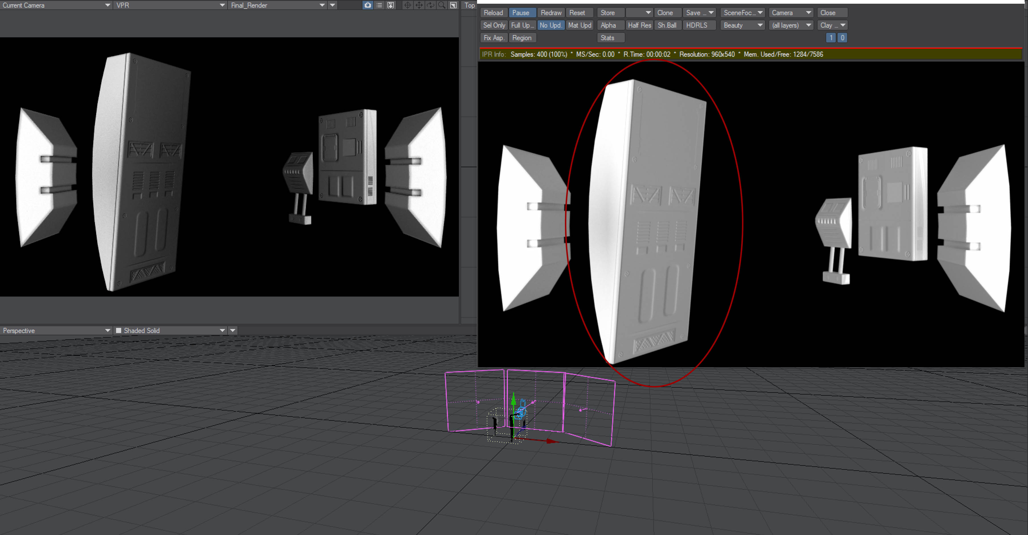

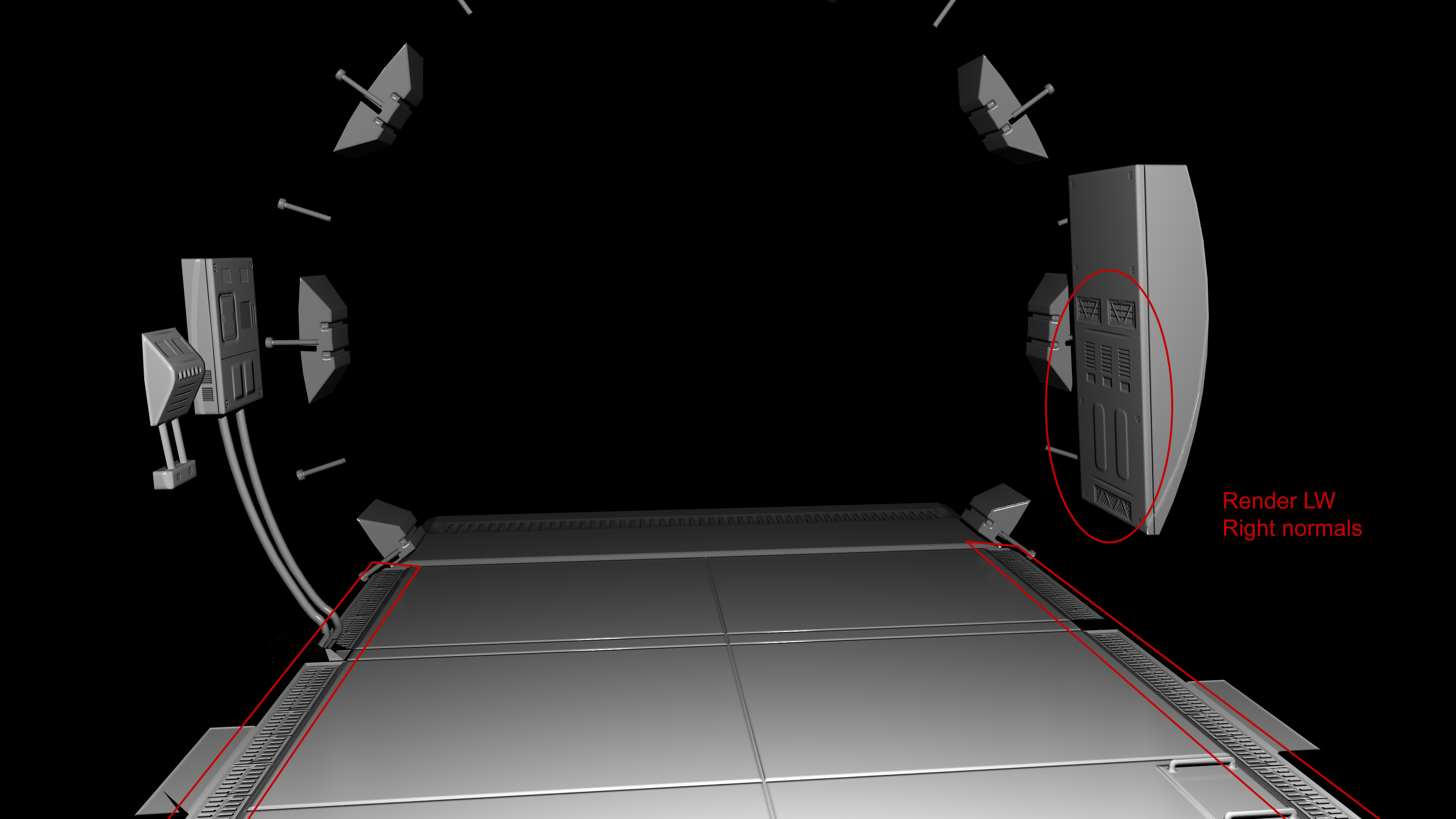

I am rendering some test and i have a problem with the normal map and Octane. I attach 2 examples with red zones where Octane flips the normal map. Native render of lightwave works fine.
any idea?
thanks!

The normals seem inverted or something like that. Do they come from an 8-bit file format, like a JPG or PNG? I ask because in this case the problem can be related to the gamma correction in the texture image node.

I have rendered in EXR format and the problem is the same. I have set the gamma of texture image node to 1 but the problem continues...

Hmm, I'm not sure what could be the problem. Have you tried to invert the texture to see if it helps? If you want to share the scene, I could take a look at it here.

Ok Juanjo, i attach the content. In the scene, the two materials are ready (LW and Octane). I attach a JPG too.

To be honest I don't know why the Octane normal mapping doesn't match the LW one. The texture flip works, but what I don't understand is why the map is good for some objects, the left ones, for example, and wrong for the other objects. I wonder if the problem is the object vertex map, or perhaps the way used by Octane to apply the normal maps using tangents or something like that.
If I find something I'll let you know, but meanwhile, you are going to need to use different materials for the left and right objects and use the texture flip to fix the objects that are wrong.
