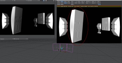

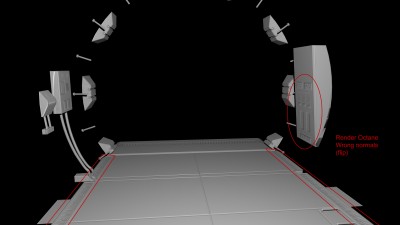

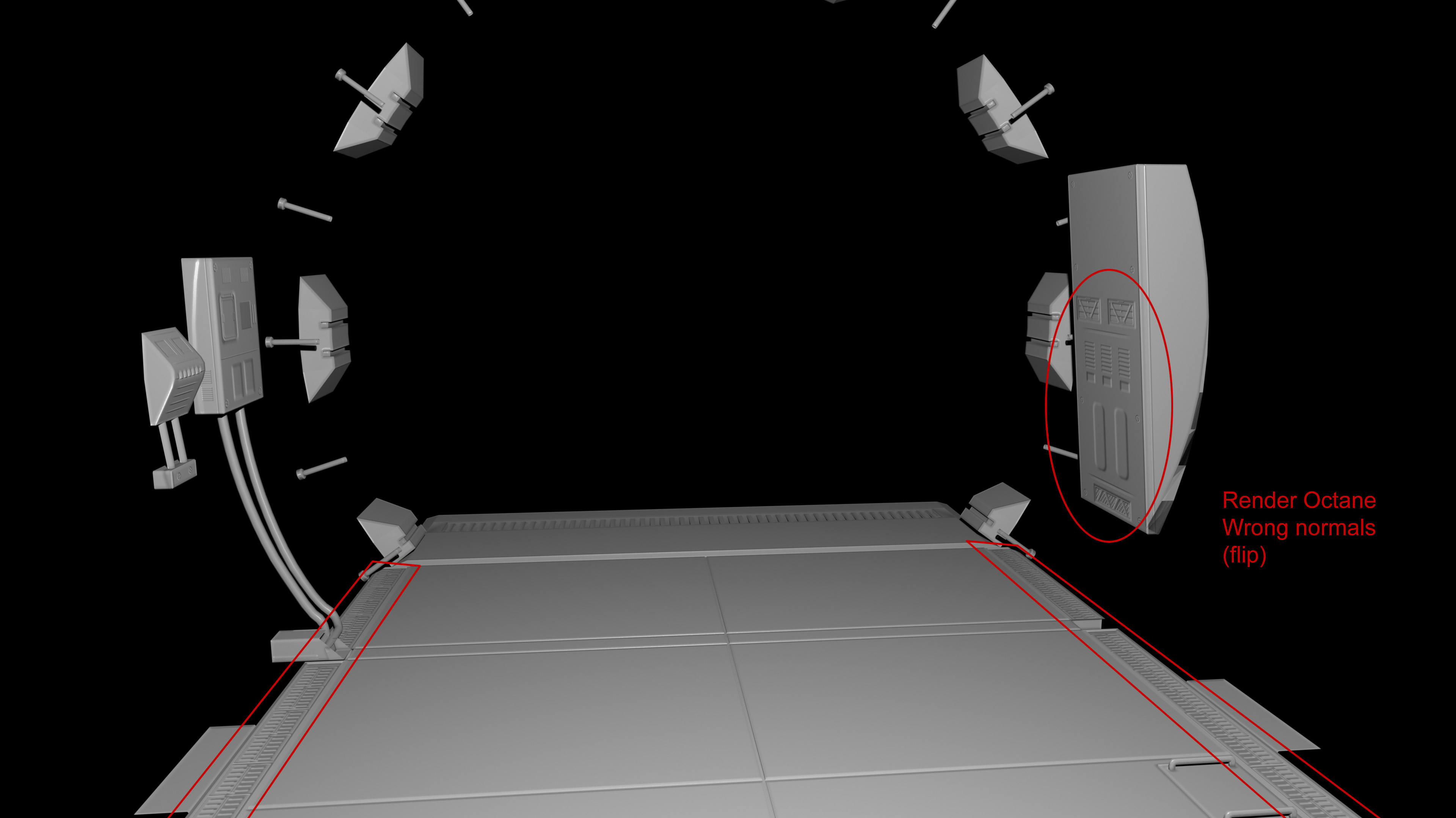

I am rendering some test and i have a problem with the normal map and Octane. I attach 2 examples with red zones where Octane flips the normal map. Native render of lightwave works fine.
any idea?
thanks!

The normals seem inverted or something like that. Do they come from an 8-bit file format, like a JPG or PNG? I ask because in this case the problem can be related to the gamma correction in the texture image node.

I have rendered in EXR format and the problem is the same. I have set the gamma of texture image node to 1 but the problem continues...

Ok Juanjo, i attach the content. In the scene, the two materials are ready (LW and Octane). I attach a JPG too.

To be honest I don't know why the Octane normal mapping doesn't match the LW one. The texture flip works, but what I don't understand is why the map is good for some objects, the left ones, for example, and wrong for the other objects. I wonder if the problem is the object vertex map, or perhaps the way used by Octane to apply the normal maps using tangents or something like that.
If I find something I'll let you know, but meanwhile, you are going to need to use different materials for the left and right objects and use the texture flip to fix the objects that are wrong.

Yes Lewis is right, actually this goes even further back than V3...
Long story short, there are two long standing issues with normal (& bump) maps in Octane:
1. They depend on UVs. If you mirrored your object, but kept UVs as they are, your normals will be flipped. To fix this you could create a copy of a material with a flipped (inverted green or red channel) normal map and assign it to the flipped part of the mesh. Or you could flip one of the channels of the normal map in your shading network. See this.
2. Depending on the camera angle, they might not render correctly. This can be solved (to some extent) by replacing the blue channel with a constant linear value of 1 (or 255 in 8bit) or by reducing the intensity of the normal map in the ImageTexture node. You could also use falloff to reduce intensity of the bump/normal on the edges. See this (apologies for the huge post, I hope those gifs help explain this).
